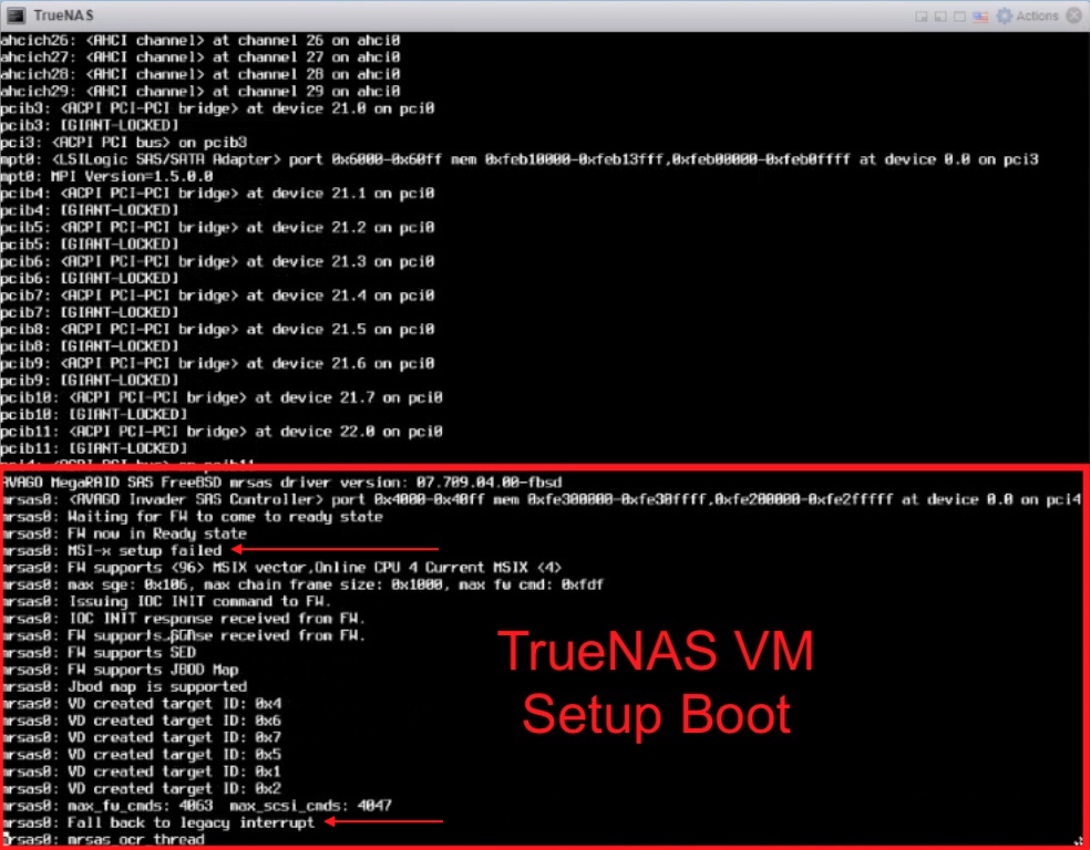

I'm unable to complete TrueNAS "as VM" installation on the following enviroment:
  • Server: Quantagrid D52B-1U
  • CPU: Intel Xeon Silver 4110 @ 2.10 GHz
  • RAM: 96 GB DDR4
  • Onboard PCI Controller with the following disks:
    • n. 1 NVMe Samsung MZQLB960HAJR-0007 960 GB
  • Avago LSI 9361-8i 12 Gbps SAS Controller, configured in JBOD mode, with the following disks:
    • n. 2 SSD Intel SSDSC2KB48 480 GB
    • n. 4 SAS WDC WUH721414AL5201
  • Hardware BIOS Settings: EUFI

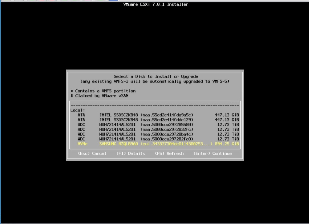

  • Operating system: VMware ESXi 7.0.1 (boot from NVMe)

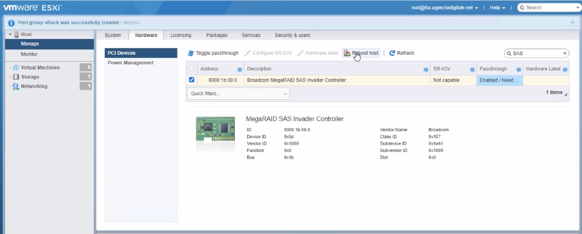

  • Passtrough device: MegaRAID SAS Invader Controller
  • TrueNAS Virtual Machine:
    • Boot virtual disk: 20 GB on NVMe Datastore
    • 32 GB dedicated RAM
    • 4 vCPU
    • PCI Device: MegaRAID SAS Invader Controller

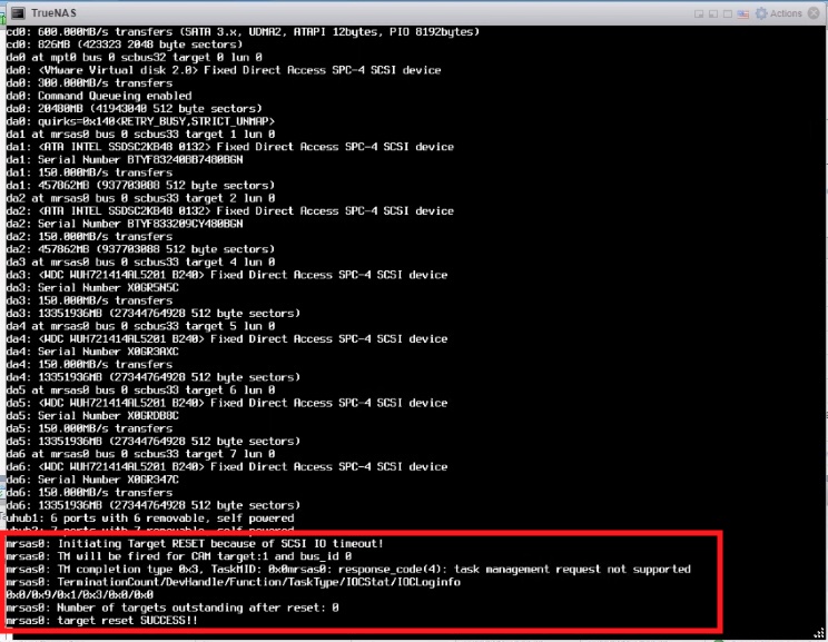

The TrueNAS setup initialization is stopping after some monites with the following message:
mrsas0: initiating target RESET because of SCSI IO timeout

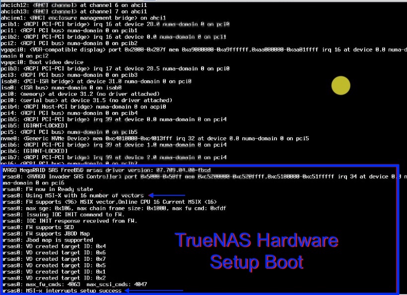

If I try to install the same version of TrueNAS directly con the "bare metal" hardware (same BIOS and HBA config) it's working fine.
What could I do to make it works in ESXi?
Thanks in advance to everyone can help me.
Francesco

I've analyzed the boot screens and I found the following difference between physical (working) and virtual (not working) setup:
I hope thus can help for a resolution.

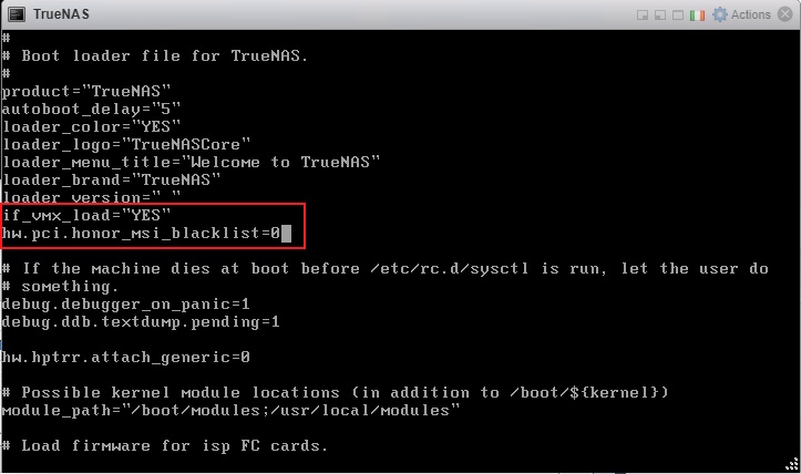

Finally, I've been able to solve the VM passtrough problem following the suggestions of this external article and the TrueNAS post-install for VMware guidelines, by adding the following lines to the "/boot/loader.conf" file:
  • if_vmx_load="YES"
  • hw.pci.honor_msi_blacklist=0

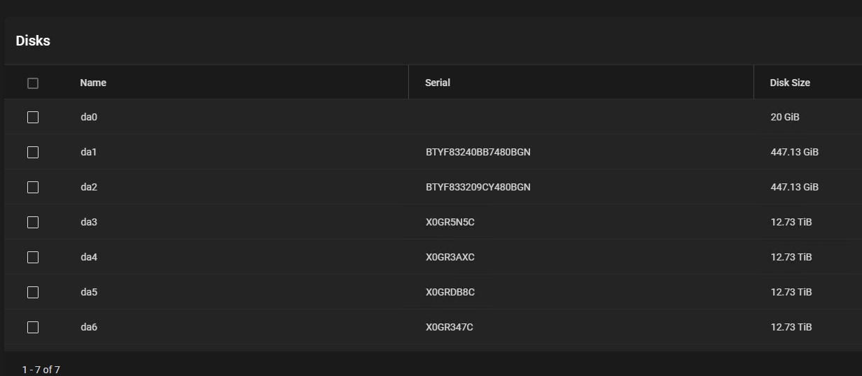

After the reboot I've added the PCI device to the VM (via ESXi passtrough) and all the disks attached to the "MegaRAID SAS Invader Controller" have been recognized. You can show the result in the following screenshots:
Do you think this configuration is ok to make me sure that I "... DO HAVE A TRUE HBA ..." ?
