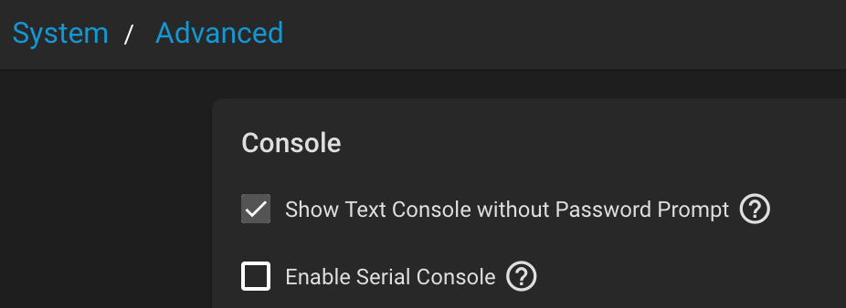

15,504
Is there a way to lock the console and have it prompt for a password?
Yes, there is.

In addition to the TrueNAS level controls that have been indicated here, you can also enforce these rules at the VMware level to prevent console connections (or other actions such as power commands!) from being sent, by setting more restrictive vCenter permissions based on group/roles there.
