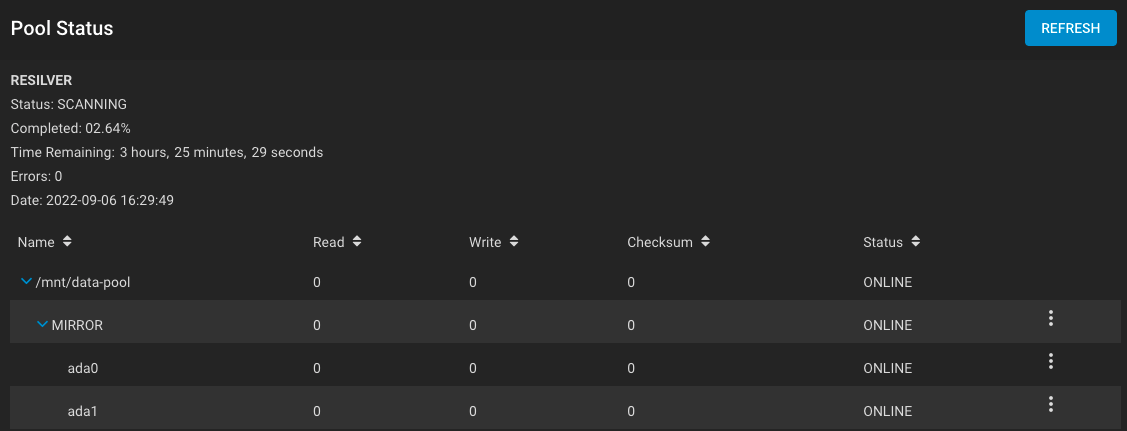

Looks like that did it, thank you.
root@truenas[~]# zpool status data-pool
pool: data-pool
state: ONLINE
status: One or more devices is currently being resilvered. The pool will
continue to function, possibly in a degraded state.
action: Wait for the resilver to complete.
scan: resilver in progress since Tue Sep 6 16:29:49 2022
558G scanned at 14.0G/s, 840K issued at 21K/s, 1020G total
0B resilvered, 0.00% done, no estimated completion time
config:
NAME STATE READ WRITE CKSUM
data-pool ONLINE 0 0 0
mirror-0 ONLINE 0 0 0
gptid/10075e9d-1b91-11ed-8c76-d85ed3d9f677 ONLINE 0 0 0
gptid/0848113e-2e2b-11ed-ba77-d85ed3d9f677 ONLINE 0 0 0
At least I now have it mirrored and if it gets full I can replace with bigger drives. Is this all I can do? Is it safe to say that if I wanted a stripe+mirror configuration I would have needed to start with at least 3 drives and create the pool with that topology?
