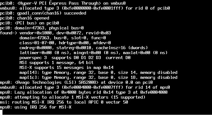

Enabled verbose message for boot option during install of TrueNAS-12.0-U1.1 and that gives some additional spew

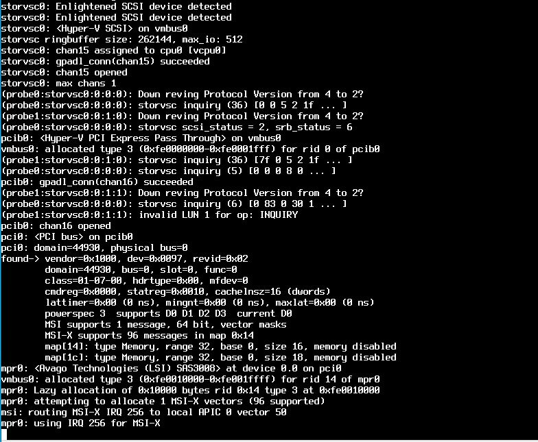

Got my hands on a LSI SAS 9300-8i. Updated to latest FW (SAS3_FW_Phase16.0-16.00.12.00_Firmware), BIOS and is in IT mode.
ESXi 6.7, Patch Release ESXi670-201912001 as hypervisor. Was able to boot and successfully passthrough the card to the guest.
ESXi 7.0, Patch Release ESXi 7.0b as hypervisor. Was able to boot and successfully passthrough the card to the guest.
HyperV on Server 2022 Insider Build 21301. TrueNAS / FreeBSD gets stuck during install (when HBA is present via DDA)
verbose boot spew
