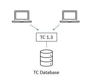

I suspect this is a valid arrangement with multiple management terminals...

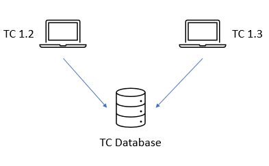

...but this is not...
My question is... does upgrading to a newer version of TC result in changes to the TC database so that a rollback to an earlier version of TC is no longer possible?

1. Multiple TC instances/versions using the same database
Answer: No, that is not recommended. I have seen a couple instances of database corruption when I startup multiple containers using the same data directory. I think it is something related to how docker does the directory->container passthrough, but I am not sure about the exact cause.
2. Rolling a 1.3 TC container back to 1.2
Answer: This is actually possible, and I do this regularly when testing out nightly/production versions of TrueCommand locally. We are very careful to not institute breaking changes in the TC database layout, specifically so that it is backwards compatible as much as possible. Now I would not assume/rely on this though, we can never predict the future and a breaking change might be needed some time in a later version.

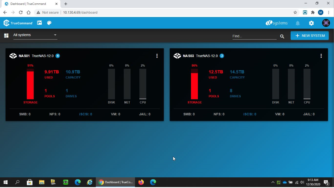

When I first saw the colour scheme for TC 1.3, like @Patrick M. Hausen in post #3, my first thought was 'WTF!', but I now understand the clever use of subdued colours. Using brighter colours for issues, makes it visually very easy to identify a server experiencing problems within a cluster of servers.

I thought it might be a theme thing, and I thought I remembered a theme setting, but in a little bit of clicking around and checking the manual (which has yet to be updated, BTW) I didn't find it.
The colour palette is in the top left-hand corner.

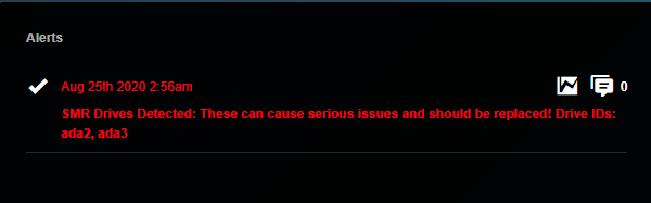

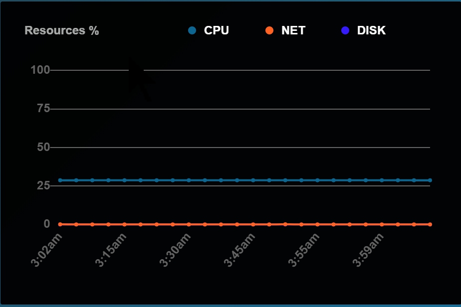

This is useful. TC 1.3 picked up that I had an SMR drive on one of my servers.

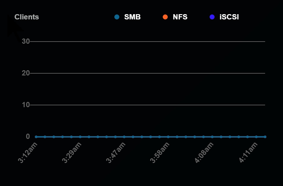

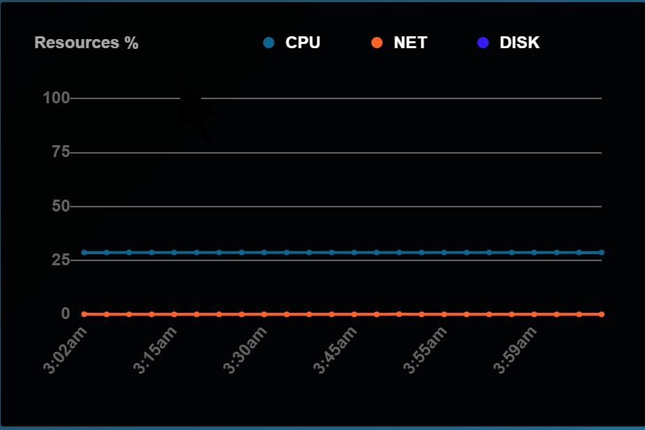

Disk is nowhere to be seen on the Resources % tile on any of my servers. Also, are flat lines expected on an active system because that's what I'm observing?
On all systems with SMB and NFS active, the Clients tile shows SMB zero and NFS is nowhere to be seen.

Just scratching my head -- based on what you posted with your graphs? How did you conclude you had a SMR drive?
Not from the graphs, but from an alert. The ability to detect SMR drives appears to be built into TC.
