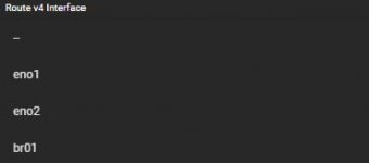

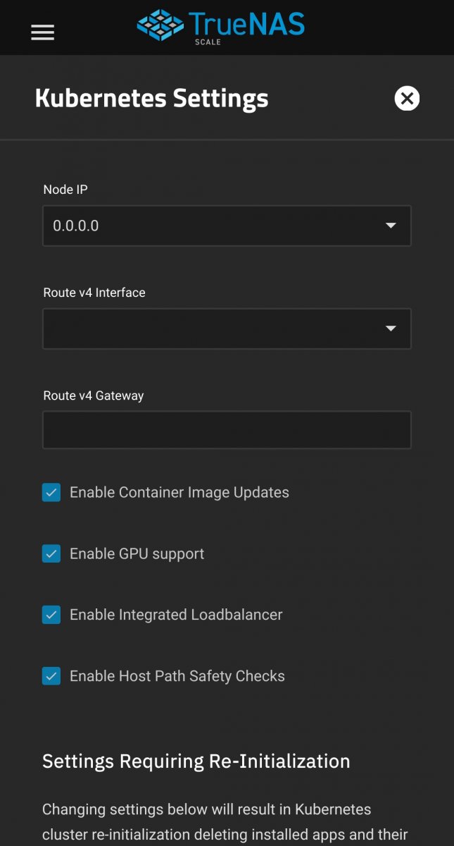

How have you set your "route v4 Interface" (under Apps | Settings | Advanced Settings)?
see the picture
not be using the HA add-on for Mosquitto
in the future I will use the homeassistant app. For this I'm try to switch zigbee2mqtt, zwavejsui and the mosquitto broker to truenas scale.
9,700
You need to set the Interface to the same bridge that your VM is on and the gateway to your router on that network.
You will need to restart the apps after doing that.

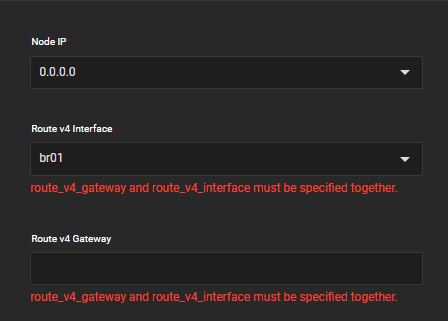

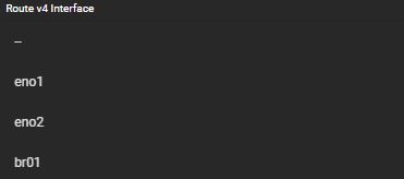

Set it to br01 or en01.

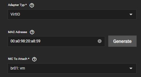

The other picture is from the vm

9,700
You attached your VM to br01, so pick that.

tryed no en1, en2 and br1 nothink work, only with the pc I can connact anytime
