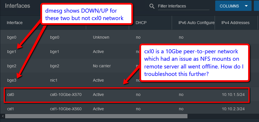

Any ideas how I can troubleshoot why two NICs reset and a third NIC (cxl0) stop working resulting in the nfs mounts to go offline on remote XCP-ng server? The freenas has the following 5 nics:

I searched dmesg and found that there is mention of bge1 and bge3 but not cxl0:

On the XCP-ng server which is directly connected via 10Gbe to cxl0, it shows the following:
Apr 29 08:03:31 XenServer70 kernel: [7539679.420431] nfs: server 10.10.1.5 not responding, timed out
Apr 29 08:03:34 XenServer70 kernel: [7539681.724438] nfs: server 10.10.1.5 not responding, timed out
Apr 29 08:03:38 XenServer70 kernel: [7539686.076346] nfs: server 10.10.1.5 not responding, timed out
Apr 29 08:03:38 XenServer70 kernel: [7539686.076384] nfs: server 10.10.1.5 not responding, timed out
The server 10.10.1.5 is the freenas nic cxl0 as you can see from the above image.
I'm confused to why dmesg shows bge1 and bge3 but not mention cxl0 which indeed had an issue. Any recommendations on how to proceed?
