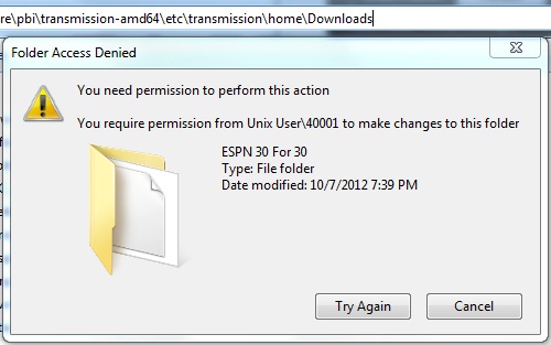

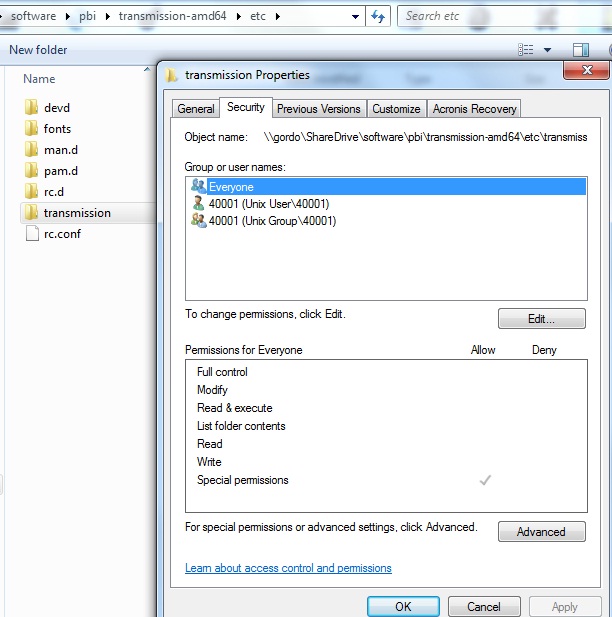

Hello, I have a problem with permissions on my watch folder and downloads folder for transmission and actually anything under the transmissions folder. I work mostly through CIFS shares and the biggest problem is the folder where i download content to does not give me full permissions to delete anything. for me this is a big problem because i can't delete anything that i download and its taking up a lot of hard drive space. Also the user that i am connecting with is the Owner on the ZFS mount however i guess this doesn't mean anything because it does not propagate down to the folders inside the mount especially the folders that were created by the transmission plugin. When i check the permission in windows it shows that unix user 40001 and unix group 40001 are the only ones that have special permissions to these folders. I think this is a built in user that got installed with the transmission plugin but i can't see the user anywhere in the GUI, maybe if i can add this user to a group or something i could get this going. Any help would be appreciated thanks!!
