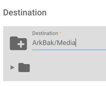

On my second dataset, I deleted the old target first, knowing it wouldn't be of use. However, then I found when creating the replication task, that I was unable to specify a target unless it already exists. This is getting super frustrating:
  1. You can't replicate a new dataset to one that already exists with snapshots.
  2. You can't set up a replication task in GUI that specifies a target that doesn't yet exist. (wrong, see below)
So I chose the backup pool as target, assuming it would make the dataset in it. No, it just plastered the new contents in the root dataset. Aaaah!!!
Edit: Duh, I didn't realize you could type into the upper part that shows the root of the path.
