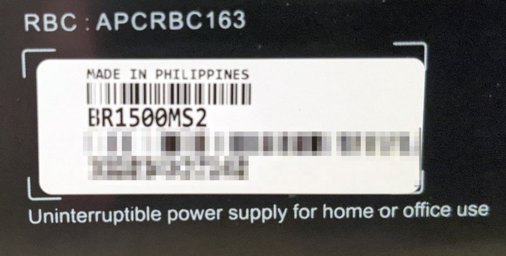

Thank you... I decided to give it a shot. Although, I am not sure I would be comfortable leaving it unattended, especially long term -- like going on vacation.
Like I said, there are detailed reports of bpth APCs and CyberPower catching fire. E.g., I read Cyberpower cheaped out on adhesive in some models, like CP1500PFCLCD, where they used this yellow glue that becomes conductive as it ages and causes short circuit which causes fire.
APC, at least in previous revisions of their BR1500MS* that I bought, tend to throw F02 error and then catch fire due to, possibly, defective MOSFETs, per this reviewer, for example:
(But I also read similar reports elsewhere.)
Do you guys leave your APCs when you go on vacations on leave home?
I honestly would rather lose data due to power outage, than my home due to a fire!
