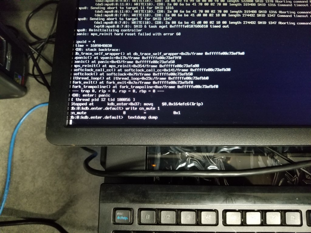

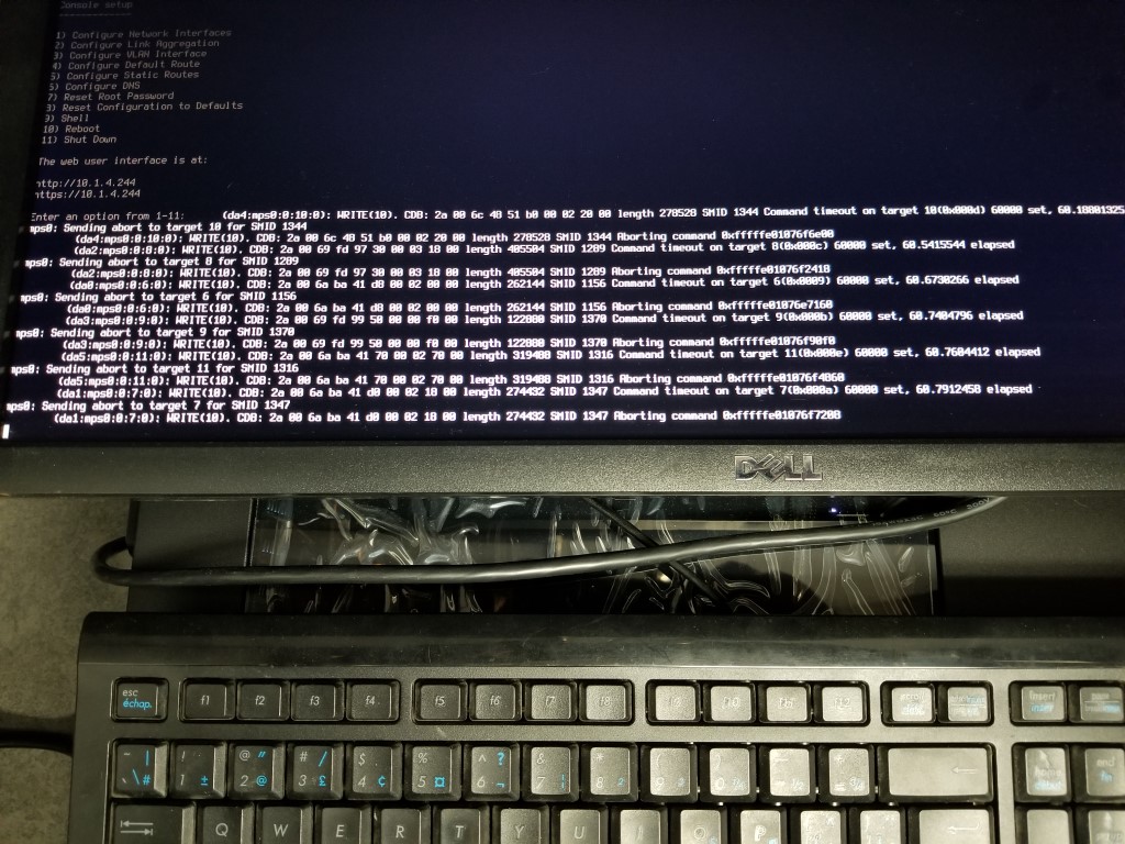

Server install and setup went without any problems. Created pool, DS, Share. Connected to share and moved about 1TB of files to the server. Then started to use two computers to copy to the server and the speeds went down to zero. Had a look on the console and had the below and attached errors. Only a restart helps. Sometimes the console is even frozen, you can’t type anything, error on screen is attached.
Looking for suggestions, don’t know what else to try. Should I get a new, up to date LSI card? It can’t be the drives since it seems to be all of the drives an error happens on.
Currently moving all 1TB of files back to external drive and then need to figure out what this problem is.

Dec 26 23:00:03 CIMSITNAS01 (da2:mps0:0:8:0): WRITE(10). CDB: 2a 00 6f 52 20 38 00 00 a0 00
Dec 26 23:00:03 CIMSITNAS01 (da2:mps0:0:8:0): CAM status: Unrecoverable Host Bus Adapter Error
Dec 26 23:00:03 CIMSITNAS01 (da2:mps0:0:8:0): Retrying command, 3 more tries remain
Dec 26 23:41:18 CIMSITNAS01 mps0: Sending abort to target 7 for SMID 1795
Dec 26 23:41:18 CIMSITNAS01 (da1:mps0:0:7:0): WRITE(10). CDB: 2a 00 65 48 88 20 00 06 00 00 length 786432 SMID 1795 Aborting command 0xfffffe00e7696c08
Dec 26 23:41:18 CIMSITNAS01 (da4:mps0:0:10:0): WRITE(10). CDB: 2a 00 65 48 88 a8 00 05 80 00 length 720896 SMID 1806 Command timeout on target 10(0x000d) 60000 set, 60.54572506 elapsed
Dec 26 23:41:18 CIMSITNAS01 mps0: Sending abort to target 10 for SMID 1806
Dec 26 23:41:18 CIMSITNAS01 (da4:mps0:0:10:0): WRITE(10). CDB: 2a 00 65 48 88 a8 00 05 80 00 length 720896 SMID 1806 Aborting command 0xfffffe00e7697ad0
Dec 26 23:41:18 CIMSITNAS01 (da5:mps0:0:11:0): WRITE(10). CDB: 2a 00 65 48 88 60 00 05 40 00 length 688128 SMID 1797 Command timeout on target 11(0x000e) 60000 set, 60.55096775 elapsed
Dec 26 23:41:18 CIMSITNAS01 mps0: Sending abort to target 11 for SMID 1797
Dec 26 23:41:18 CIMSITNAS01 (da5:mps0:0:11:0): WRITE(10). CDB: 2a 00 65 48 88 60 00 05 40 00 length 688128 SMID 1797 Aborting command 0xfffffe00e7696eb8
Dec 26 23:41:18 CIMSITNAS01 (da2:mps0:0:8:0): WRITE(10). CDB: 2a 00 65 48 87 e8 00 04 c0 00 length 622592 SMID 1798 Command timeout on target 8(0x000b) 60000 set, 60.55769840 elapsed
Dec 26 23:41:18 CIMSITNAS01 mps0: Sending abort to target 8 for SMID 1798
Dec 26 23:41:18 CIMSITNAS01 (da2:mps0:0:8:0): WRITE(10). CDB: 2a 00 65 48 87 e8 00 04 c0 00 length 622592 SMID 1798 Aborting command 0xfffffe00e7697010
Dec 26 23:41:18 CIMSITNAS01 (da2:mps0:0:8:0): WRITE(10). CDB: 2a 00 65 48 8d 28 00 00 80 00 length 65536 SMID 1803 Command timeout on target 8(0x000b) 60000 set, 60.57001258 elapsed
Dec 26 23:41:18 CIMSITNAS01 (da3:mps0:0:9:0): WRITE(10). CDB: 2a 00 65 48 82 a0 00 05 00 00 length 655360 SMID 1820 Command timeout on target 9(0x000c) 60000 set, 60.60155660 elapsed
Dec 26 23:41:18 CIMSITNAS01 mps0: Sending abort to target 9 for SMID 1820
Dec 26 23:41:18 CIMSITNAS01 (da3:mps0:0:9:0): WRITE(10). CDB: 2a 00 65 48 82 a0 00 05 00 00 length 655360 SMID 1820 Aborting command 0xfffffe00e7698da0
Dec 26 23:41:18 CIMSITNAS01 (da0:mps0:0:6:0): WRITE(10). CDB: 2a 00 65 48 82 a8 00 05 00 00 length 655360 SMID 1691 Command timeout on target 6(0x0009) 60000 set, 60.67151391 elapsed
Dec 26 23:41:18 CIMSITNAS01 mps0: Sending abort to target 6 for SMID 1691
Dec 26 23:41:18 CIMSITNAS01 (da0:mps0:0:6:0): WRITE(10). CDB: 2a 00 65 48 82 a8 00 05 00 00 length 655360 SMID 1691 Aborting command 0xfffffe00e768e048

Since its across multiple drives I'd suspect controller is at fault here. Try the usual, reseat, check temps, and if all else fails, replace.
