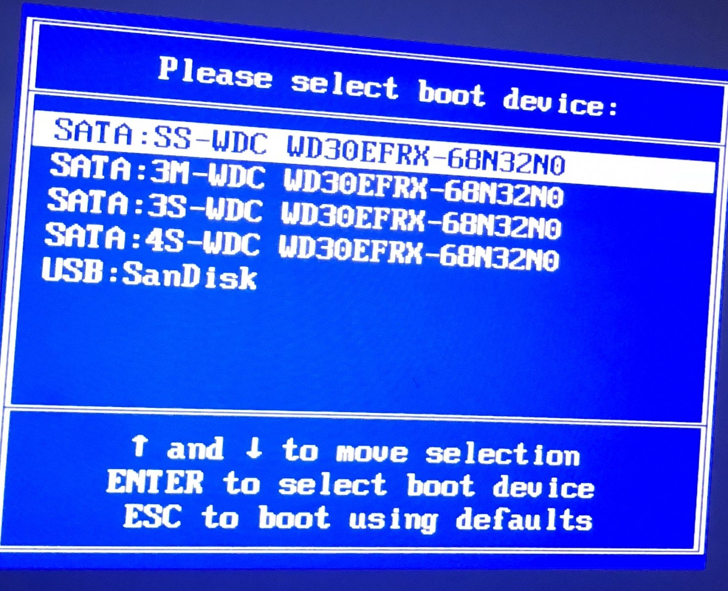

Okay so I finally get in with F8 and select my usb drive and still get same error after it restarts. Thoughts now?

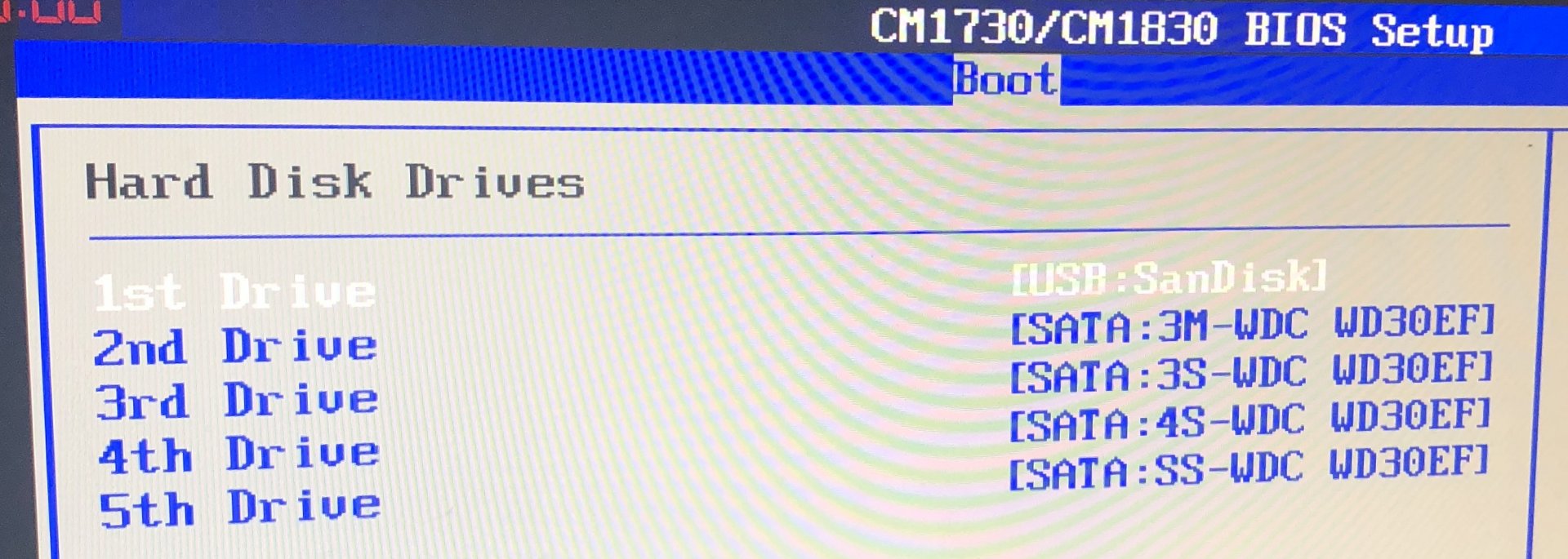

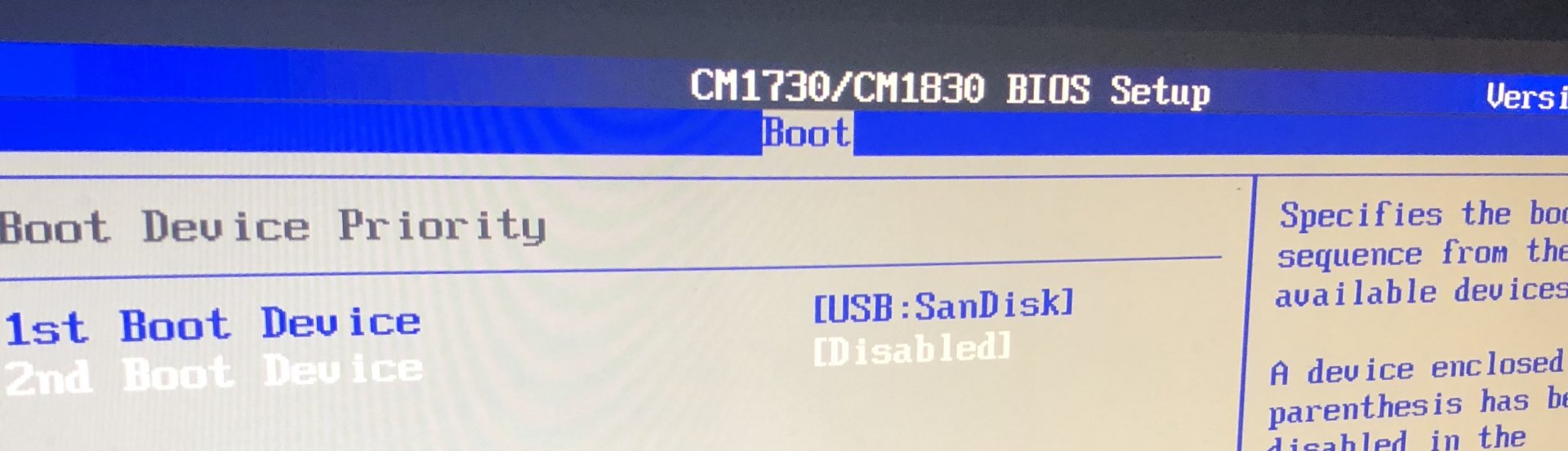

To update I also did it here in the bios and now it’s it’s just constantly restarting. So I’m guessing there’s an issue with the usb drive?

That last thing you did is a great test.
Yes it’s possible the USB key.
Try making it with a tool called win32diskimager.
Also try looking for a different bootable iso to test such as a Ubuntu live CD
Finally try another key.
You’re learning, good stuff
