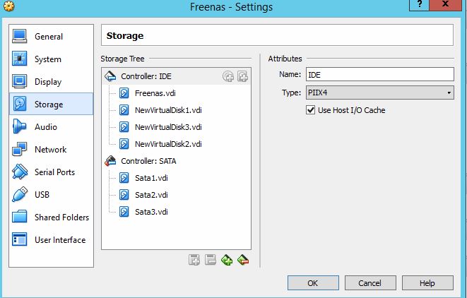

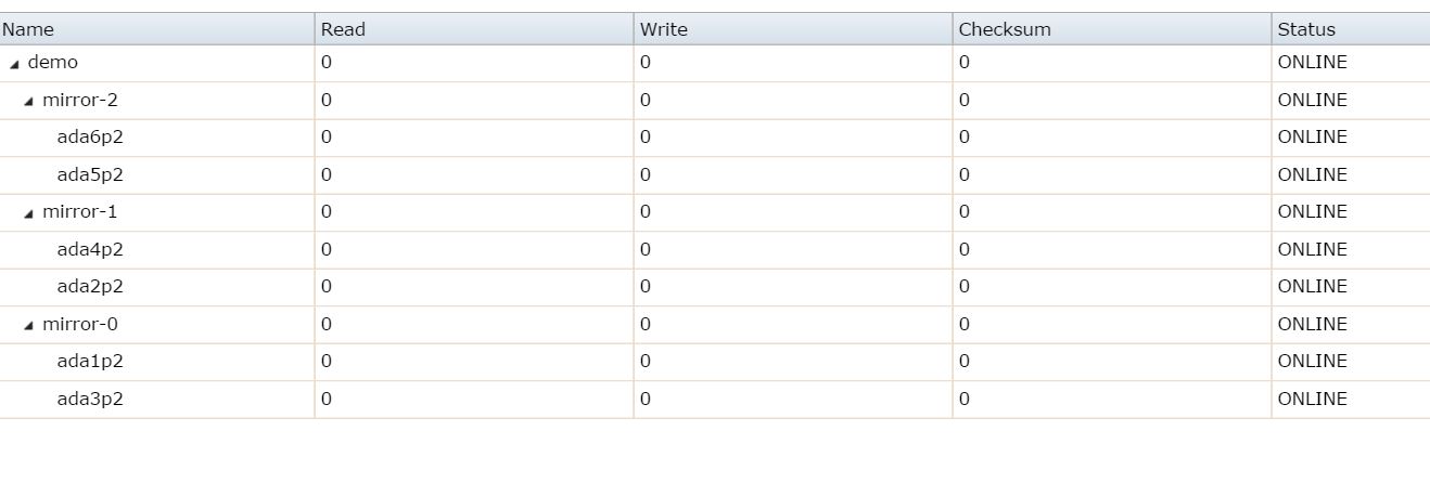

I added 4 more drives via VM. I chose expand volume. Should this be a ZFS drive where i can simulate drive failures?

It's kind of difficult to simulate meaningful drive failures in a virtualized environment. You can remove a disk, but that's kind of drastic.
