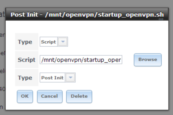

2. My simple startup script isn't running
I have a simple startup script intended to start openvpn. Here it is, "startup_openvpn.sh":
#!/bin/sh
cd /mnt/openvpn
openvpn server.conf
/mnt/openvpn/server.conf is the config file for openvpn.
openvpn is in PATH.
/mnt/openvpn/startup_openvpn.sh is where the script is located.
I used the GUI to select this script as a "post init" script. But it's not starting openvpn. What am I missing?

I'm afraid to submit a bug on number 2 because this is my first script and I am probably doing something wrong. Number 1 was so simple that I can't imagine having done anything wrong. Although, both of these bugs seem to be related to startup-type things, hmm.
Here's more details on the 2nd issue.
I made a directory for storing my openvpn files. This shows me listing the directory and, the script (startup_openvpn.sh) and the permissions (which include execute for all).
[root@freenas] ~# cd /mnt/openvpn
[root@freenas] /mnt/openvpn# ls
./                  ipp.txt              sample-config-files/
../                  openvpn-status.log  server.conf
client.ovpn          openvpn-status.log:  startup_openvpn.sh*
easy-rsa/            openvpn.log
[root@freenas] /mnt/openvpn# ls -l startup_openvpn.sh
-rwxr-xr-x  1 root  wheel  46 Jan 26 22:01 startup_openvpn.sh*
Here's the whole script
#!/bin/sh
cd /mnt/openvpn
openvpn server.conf
And here's what the GUI setting looks like.

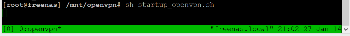

When I run the script from the command line as root, it works fine:
Is /mnt/openvpn a volume or really just a directory created via mkdir? /mnt itself is a tiny ramdisk and will not survive a reboot.

Dusan,
openvpn is a dataset that I created via the ZFS manager.
I can't remember how I mounted it, it was so many hours of messing with this system ago. I might have just gotten lucky by typing something like "mount openvpn" and then getting the result I wanted. Not what I'd do on my final machine but this is just an experiment box to learn on.
So, I'm pretty sure /mnt/openvpn is a legit volume, but how would I check what you're suggesting?
I can tell you, it definitely survives reboots, because I have copied the easy-rsa files in there and store my openvpn config files there too.
Thanks for your help.

Could you please post output of:
zpool list
zfs list
mount
cat /etc/fstab
scurrier
Jan 2, 2014
297
[root@freenas] ~# zpool list
NAME      SIZE  ALLOC  FREE    CAP  DEDUP  HEALTH  ALTROOT
openvpn  230G  1.48M  230G    0%  1.00x  ONLINE  /mnt
[root@freenas] ~# zfs list
NAME      USED  AVAIL  REFER  MOUNTPOINT
openvpn  1.42M  226G  1.02M  /mnt/openvpn
[root@freenas] ~# mount
/dev/ufs/FreeNASs1a on / (ufs, local, read-only)
devfs on /dev (devfs, local, multilabel)
/dev/md0 on /etc (ufs, local)
/dev/md1 on /mnt (ufs, local)
/dev/md2 on /var (ufs, local)
/dev/ufs/FreeNASs4 on /data (ufs, local, noatime, soft-updates)
openvpn on /mnt/openvpn (zfs, local, nfsv4acls)
[root@freenas] ~# cat /etc/fstab
/dev/ufs/FreeNASs1a / ufs ro 1 1
/dev/ufs/FreeNASs3 /cfg ufs rw,noauto 2 2
/dev/ufs/FreeNASs4 /data ufs rw,noatime 2 2
/dev/ada1p1.eli none                    swap            sw              0      0
Dusan
Jan 29, 2013
1,165
Can you try to change the last line of your script to:
openvpn server.conf &
scurrier
Jan 2, 2014
297
Dusan,
I tried your suggestion but it didn't work. Any other ideas?
