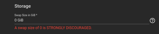

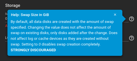

In 2020, IXsystems removed theswapondrive
option from UI and set as default"swapondrive": 0
in Core.
I don't understand also, thank you for the screenshots. See NAS-106531.I'm getting mixed messages then
