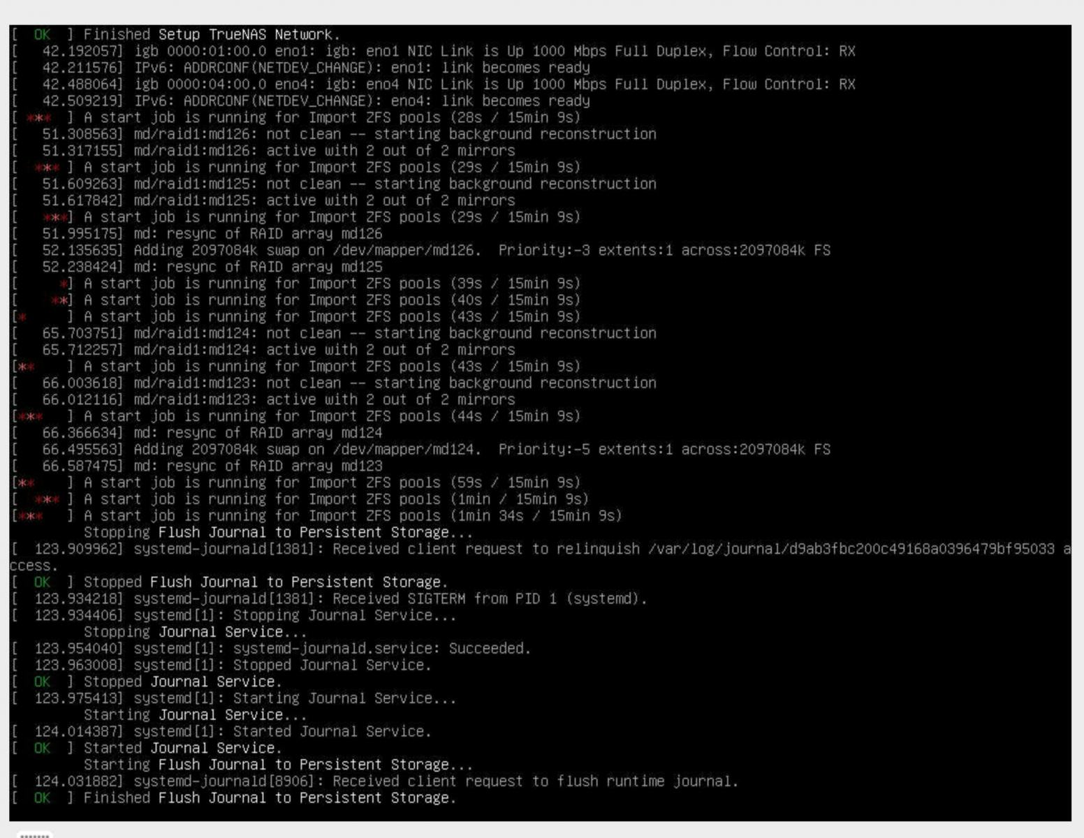

I'm curious I'm an outlier here, but I'm seeing all the raid1 swap partitions getting rebuilt every boot -- even clean restarts. Is that normal, and if so is there some reason?

Thanks, I get that. But still curious why the swap MD raid1 devices are marked unclean and re-constructed each boot -- even with no disk configuration changes and a clean reboot. It's as though they aren't cleanly unmounted or maybe can't be for some reason?

I also see this in dmesg. It looks bad, even if it's by design.
I'm not sure if I interpret the log correctly but it looks like it means some time is wasted cleaning them on boot.

Thanks... Since I'm not alone I filed a bug. It seems unintended and definitely takes boot time (even on a decent machine) if there are a bunch of spinning drives.

Updated to 22.02.3 but this is still an issue for me. Takes over 15 minutes to reboot while it rebuilds encrypted raid 1 swap partitions. (presumably because they aren't cleanly unmounted?) Fun part is that I have to reboot twice after updates because of another issue with rrd data for some reason.
Anyway, if anyone else has veeeeerrrry long boot times for Scale, I have an issue here: https://ixsystems.atlassian.net/browse/NAS-116662
You can check if you hare having swap rebuilt by running
dmesg |grep 'not clean'

Same for our system too running TrueNAS-22.02.2.1 on epyc, was curious to know if it holds true but as it turns out, the sw raid is for the swap.
root@truenas[~]# dmesg |grep 'not clean'
[ 26.988091] md/raid1:md127: not clean -- starting background reconstruction
[ 27.021430] md/raid1:md126: not clean -- starting background reconstruction
[ 27.067276] md/raid1:md125: not clean -- starting background reconstruction
Running raidz on 6 disk.
