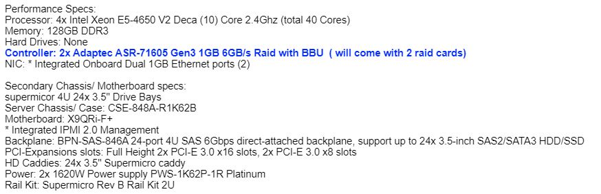

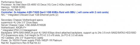

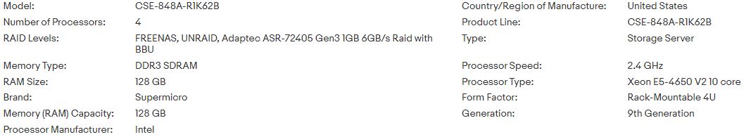

I've attached the 2 listings I received for the hardware configuration. The one does list the backplane that might help determine the cards I should look at replacing the Adaptecs with as you seem to have a good understanding of these components.
As for the drive replacement plan, that is a key piece of information important to how that would work that wasn't included in the blurb I read. It makes sense though given how RAID typically works. It means that I will have plan for a 2-step migration which really add to the complexity. But thank you for pointing that key distinction out about how that feature works.
Please let me know if that configuration helps at all with narrowing down which HBAs I should specifically look at.
Shawn
