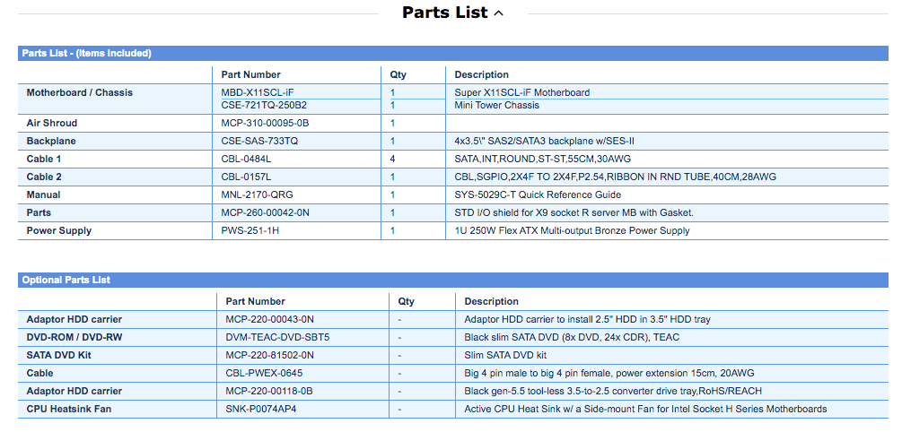

I found this on the Supermicro site description of the barebones system that I plan to order. The CPU heatsink does not appear to be included.

Sorry, mine came with CPU and heatsink included. Check with Supermicro or your preferred reseller.
