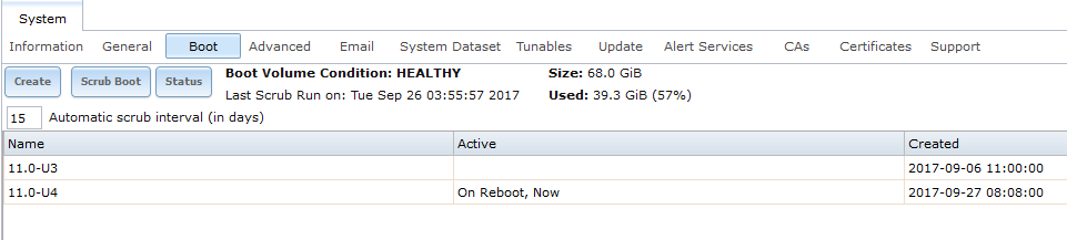

I have my server setup so that my boot disk is a single high reliability 76GB 15k 6GB/s SAS disk. I have had no issues with it, never SEEMS to bog down, and for over 3 years now has been my OS disk, without even a hickup.
HOWEVER, my reboot time is around 30 minutes and from the time I click "reboot" to the time the GUI comes back up, is actually over 30 minutes. It used to be around 10, but since updating, the newest version FreeNAS 11 it is taking FOREVER.
I also noticed that even with 3 boot volumes, I am maxing out my space on the disk. In the past, I have tried to start fresh, by re-installing FreeNAS, and then uploading my backed up configs. This seemed to work perfect, as far as everything being the way it was BEFORE the wipe, but then I see a few anomylous bugs that come back, like an old IP address "WARNING: Sept. 28, 2017, 8:29 a.m. - The WebGUI Address could not bind to 10.0.30.1; using wildcard" while my current IP range is 192.168.*.*, and slow performance.
So, I actually have a lot of questions.
1. How are people using 32GB USB thumb drives, when my 2 boot volumes alone use 39GiB????
2. Would there really be ANY appreciable difference between a USB and a SAS disk? I feel like most SAS disks are faster than USB anyway.
3. Am I doing something wrong?
4. Should I start fresh without importing my configs? If so, how can I redo all my configs, without losing data?
I am OK with manually doing the work, but the data is the concern.
Something is wrong with your configuration. My boot drive is 32GB and it has room to spare. It was less than half used last I looked.
There is no advantage to a SAS disk at all. I use a mirrored pair of 2.5" laptop hard drives and it works great. Reboot time (estimated) is less than 10 min. It doesn't bother me to sit and wait for it.
I am not saying that you are doing something wrong, but there is something wrong.
Your config has nothing to do with your data. The data is safely stored on the pool and none of it is in the boot drive. When you get to the point of crating a pool, import the existing pool instead of creating a new one. As long as you don't wipe your data drives, you should be fine.
I would wipe that boot drive and do some testing on it because a defect may have developed.

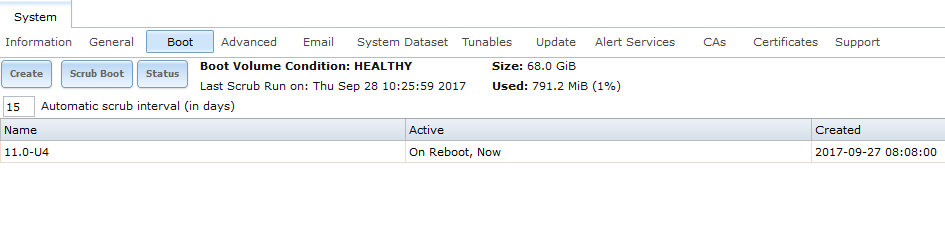

Found the issue to at least #1 because of this thread.
Still have 20GiB of used space though. But much better!

I have a 16GB usb drive as my boot and I am using 1.4GB for 3 different boot environments.
  1. Initial install
  2. default
  3. 11.0-U3 (on Reboot, Now)
so yeah, something is wrong in your setup which is taking that much space for the boot drives. Check your folders again, maybe you have some other artifacts than the 19GB folder you found. Some cron job or rsync task putting data in the boot pool rather than the data pool.

Whatever was in 11.0-U3 was taking up all the space. Removed it, and down to 791.2 MiB
Soooo, now that my disk size problem has been solved, WTH is up with the slow boot times? I am keeping Freenas pretty busy, 3 VM`s, and 8 jails, 11 disks in Raid Z3, and 4 Pools. But I cant imaging that all of those things would bog it down that bad. I mean the R410 server undoubtedly can handle all of that without breaking a sweat, and I almost never see the CPU go above 20%.
But now you have no other boot environment to go to in case U4 craps out. Make backups of the config.
It might be that the upgrade from U3 to U4 wrote some files which were not cleared or somehow the process got interrupted which resulted in the boot pool blooming to 39GB. I have not yet upgraded. I have read about many people having issues with U4 upgrade. I am going to wait a while before upgrading.
