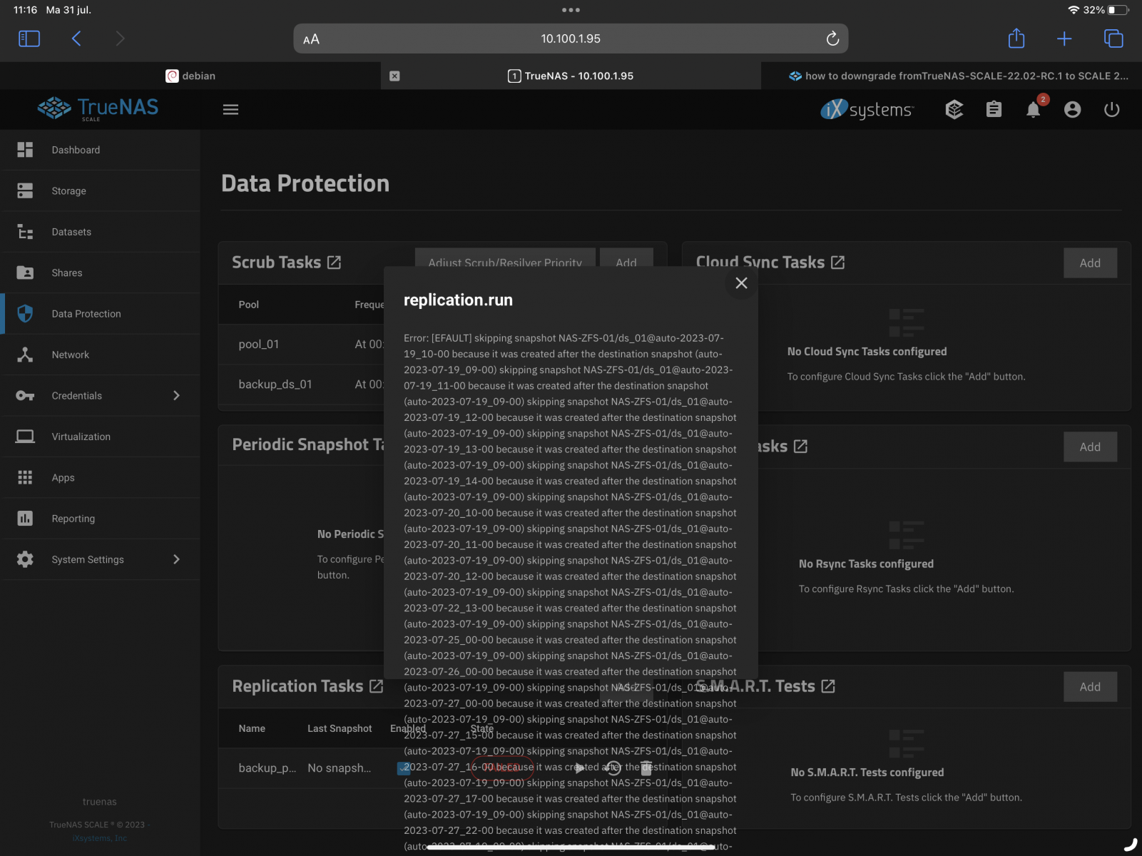

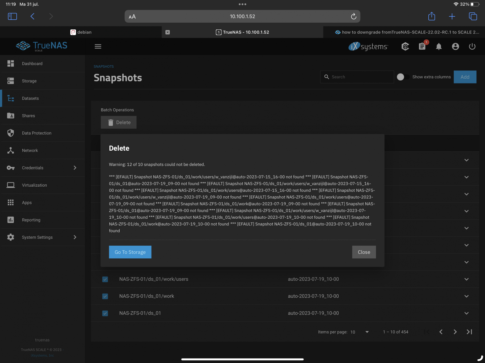

When I try to run the pull replication task on the backup system an error pops up in the task. I am getting an error about skipping dataset main machine ……. because it was created after the destination snapshot. ok so I go to my main web ui and login and got to snapshot and see indeed there is a snaphot there and when trying to delete it it says snapshot not found. How is this possible? Is there a known bug in de web ui? I can’t seem to find the solution. I am not going to rebuild the pool because there are many many child datasets involved for easy backup and sharing.
Let me know if anybody has the same problem. Or how they deleted there snaphots that are not found.

I've done a search in snapshots where two screens of results were returned, clicked on the 'select all' box above the first result and hit DELETE. The first screen of snapshots got deleted, but the whole second screen returns 'not found'. I suppose the deletion command wiped the whole search result in terms of snapshots, but the UI records for the second screen of results stayed. I now have 9 snapshots that I can't delete from the UI as they are 'not found' on the filesystem.

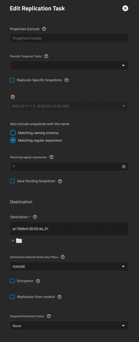

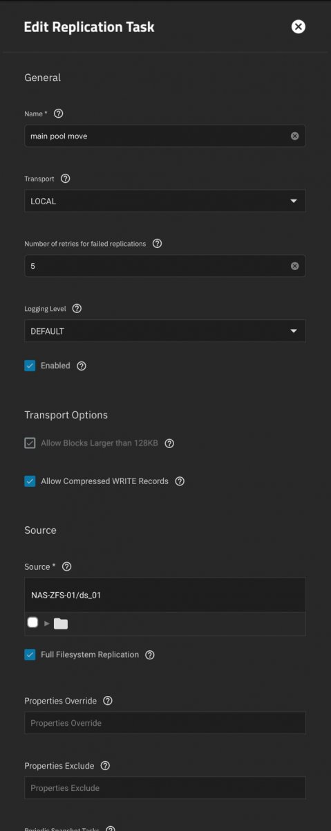

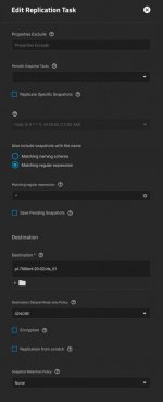

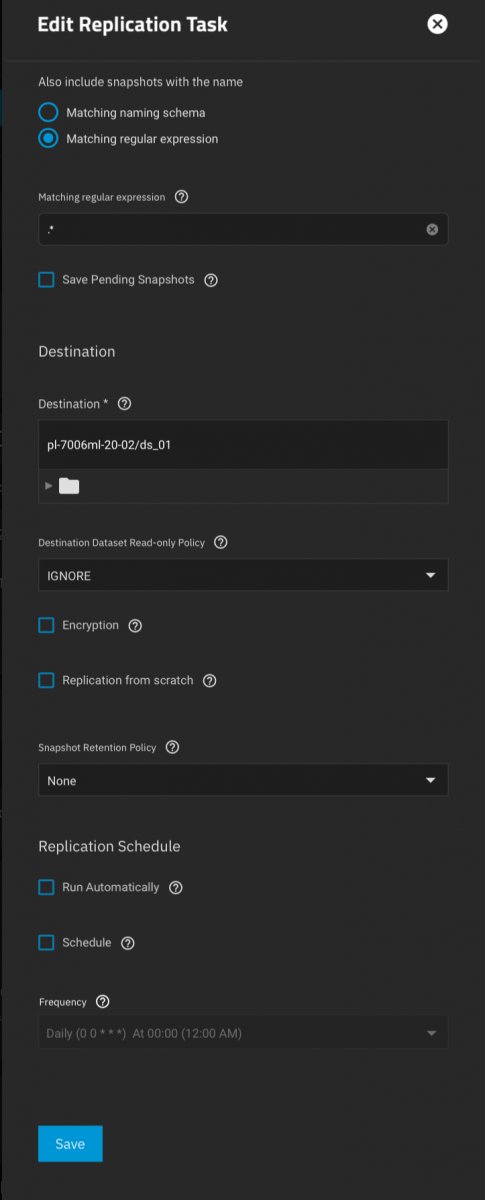

I recently purchased an hpe dl360 sff gen 9 and I have to figure out wich lsi hba i need because my p440ar isn’t an option as i have been reading. So I got my 3 of my 4 3,5 disk hooked up to the old pc and 3x 2,5 disk and replicate as a push on the same machine to the new pool and with these settings. Picture added! You can try these settings and see if it works. Especially the part in the replication task “Matching regular expression”
and use .* so a dot and a star. Then there where no errors from the pull.
