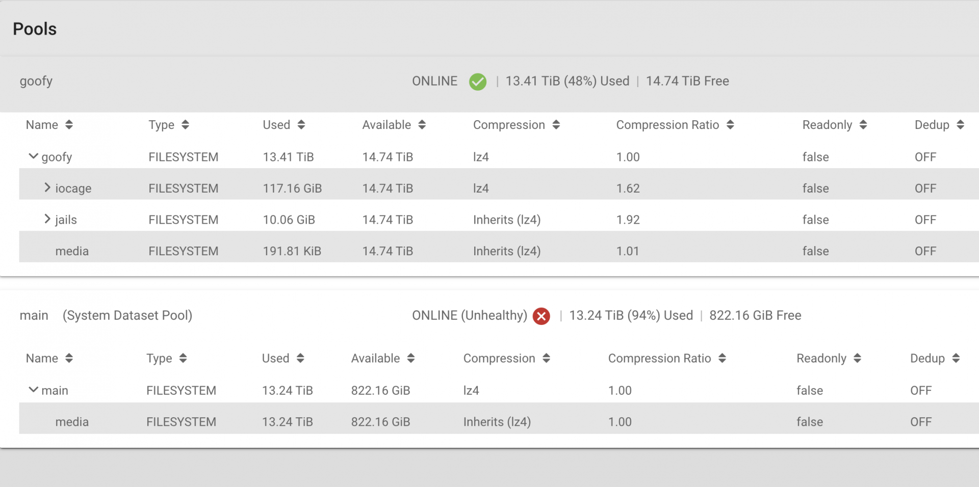

I'm back! Took me a while to get things done, this isn't really a top priority, but I've run into some problems.
I ended up with a 6x8TB in a Z2 array. I successfully moved my iocage and jails datasets over to the new pool. But I'm running into problems with my media dataset (13TB).
There were bad sectors on the old array in that dataset. When I used zfs send/receive it would fail consistently at something like 6.34TB in. So I said screw it and just used rsync to copy the data over. That seemed to have worked, until I rebooted. Now my dataset is empty, but the pool is claiming to have used the 13TB.
So my question is, where is the data? How do I get it back to the dataset and make it visible? Looking at the screenshot, goofy is the new pool, main is the old. goofy claims to have used 13.4TB but none of the datasets show it.
