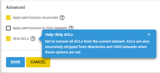

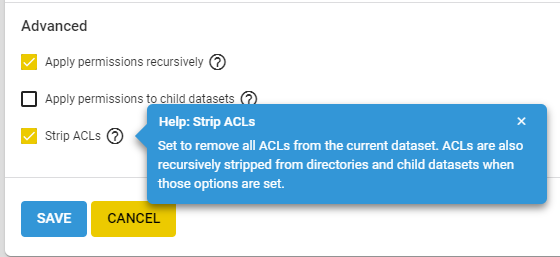

Unfortunately, using the GUI to strip out ACLs to start over with ACLs only strips out the top level of a share.
To actually strip out the ACLs, you have to run
find . -exec setfacl -b {} \; from the root of the share.
