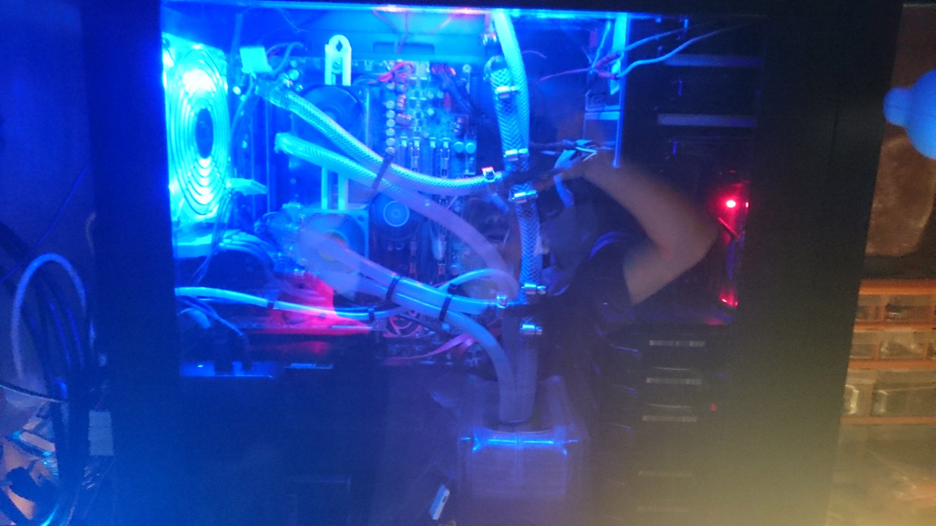

Corsair 700D case, ASUS K8N-DL Extended ATX Server Motherboard, Dual Socket 940, NVIDIA nForce4 Professional, 2x Opteron 285 (Dual Core, 2.6Ghz overclocked to 2.7Ghz), watercooled and fan cooled, 12GB Memory ECC 400mhz, 4x3TB WD Red, 1x60GB Corsair SSD, OnBoard Gigabit lan plus 2x Gigabit lan cards, 750 Watt PSU.
