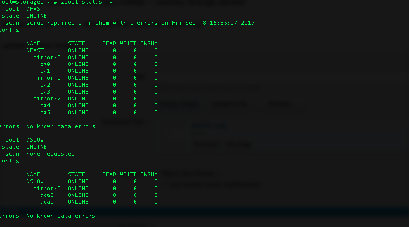

Hi forum , I am building a new nas with freenas 11-rc3 and I am receiving some messages:
GEOM: da0: the primary GPT table is corrupt or invalid.
GEOM: da0: using the secondary instead -- recovery strongly advised.
GEOM: da1: the primary GPT table is corrupt or invalid.
GEOM: da1: using the secondary instead -- recovery strongly advised.
GEOM: da2: the primary GPT table is corrupt or invalid.
GEOM: da2: using the secondary instead -- recovery strongly advised.
GEOM: da4: the primary GPT table is corrupt or invalid.
GEOM: da4: using the secondary instead -- recovery strongly advised.
GEOM: da5: the primary GPT table is corrupt or invalid.
GEOM: da5: using the secondary instead -- recovery strongly advised.
all the disks are new , any idea that could be happening?

GEOM shows that message when you write over the primary gpt table. Maybe with a dd command.

It's not FreeNAS, it is the underlying operating system. The GPT partition table is written to the first 34 blocks of the disk, and a backup of that table is written to the last 34 blocks of the disk. What this message is saying is that a GPT was written, then the primary table at the start of the disk was overwritten. The GEOM subsystem found the backup/secondary copy of the table at the end of the disk and is using that.
This is usually caused by people not understanding the two tables that GPT has and treating it like the old MBR format, which only had one table.
Others have suggested using the FreeNAS GUI. I agree with that, it does several things that are well-tested and create vdevs and pools that are well-formed and in the format that FreeNAS expects. In this case, now would be a good time to fix these problems, before a lot of data has been copied to the pool.

ok I'll follow your advice, I still have no data in the pool, I think it's a good time to redo all the pool
