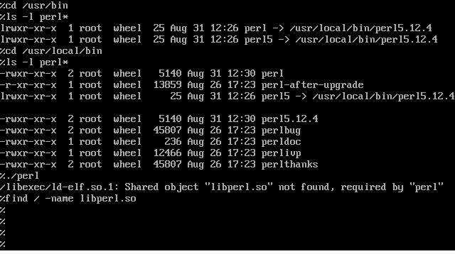

the error is caused by a missing symlink, there's an easy fix:
I just installed the 32-bit version of FreeNAS 8.0.1 RC1 into a VM. I can't figure out how to fix this just by adding a link. Screenshot attached.

Hmm weird, it did fix the issue when it occured on my box...
What do you get when you just execute
perl -v
from anywhere?
The issue with the missing symlink is, that most perl-scripts require perl to be at /usr/bin/perl. By default FreeBSD creates this symlink is created when perl is installed.
pallfreeman
Sep 1, 2011
38
Was it a fresh install of RC1?
perl -v
from anywhere?
Shared object "libperl.so" not found, required by "perl". Not surprisingly, since the find on the end of that screenshot up there didn't find one.
Yeah. It's the FreeNAS (and NanoBSD) differences that keep tripping me up. I can generally find my way around FreeBSD OK.
I'm so modest. I've been using FreeBSD since 2.2.5. :)
