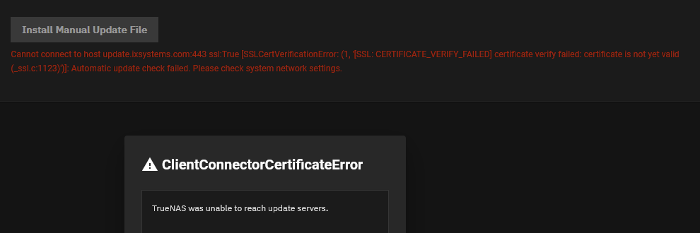

Hi Guys,
im totally new in the world of (True)NAS. I decided to start with a selfbuild NAS with Scale as OS.
After the fresh Installation, getting into all Settings, set up the Pool i decided to test the Update function as well and i noticed there was no train option available.
i got this error message:
After googling a bit i found some things to evaluate...

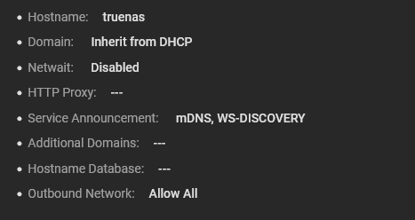

Nameservers: Correct and working well (FritzBox Modem)
Ping Google: Worked

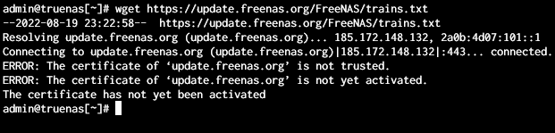

Download a File from HTTPS: Failed 'wget https://update.freenas.org/FreeNAS/trains.txt' (Source)
Am i missing something?

I checked that before but yeah ... the obvious answer is mostly the correct one ... bios time was a bit async ... isnt there a service as in windows where linux update also the bios time?
