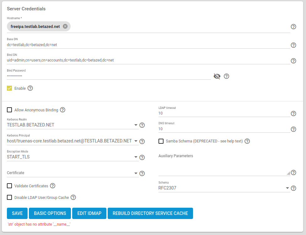

Hello tikenn, can I ask about your LDAP configuration please? I'm trying the same thing and when I edit the LDAP configuration, open the advanced settings and select the kerberos realm and kerberos keytab (which one- the host or ldap) - I cannot save the result because of "'str' object has no attribute '__name__'".
Can you please post your complete config? Thanks.
What version of TrueNAS are you using?
Troublegum
Jun 17, 2021
4
Freeipa on Centos 8
IP: 10.88.88.3/24
Hostname: freeipa.testlab.betazed.net
TrueNAS Core 12.0-U4
IP: 10.88.88.17/24
Hostname: truenas-core.testlab.betazed.net
Add host to ipa-server
[admin@freeipa ~]$ ipa host-add truenas-core.testlab.betazed.net --ip-address=10.88.88.17
Added host "truenas-core.testlab.betazed.net"
  Host name: truenas-core.testlab.betazed.net
  Principal name: host/truenas-core.testlab.betazed.net@TESTLAB.BETAZED.NET

Added screenshot with error message in GUI. The error appears as soon as I select
Kerberos Realm and Kerberos Principal in the advanced settings.

Okay. Probably related to trying to use start_tls + gssapi simultanesouly. Exception isn't being translated properly. Disable start_tls, we will do a sealed gssapi bind.

Thank you, disableing encryption allowed for saving the settings without an error message.
The desired LDAP functionality seems to be working for me. I can ssh into truenas with freeipa accounts when I get a kerberos ticket.
It doesn't use the ssh public keys stored in freeipa. Next on my list to try out is nfs4 with kerberos.
