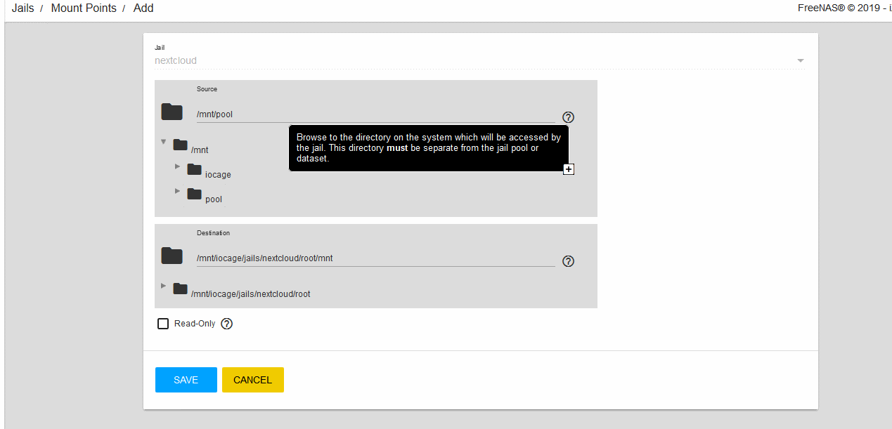

You still have not mentioned your FreeNAS version, but with version 11.2 (u5) it should look like this:

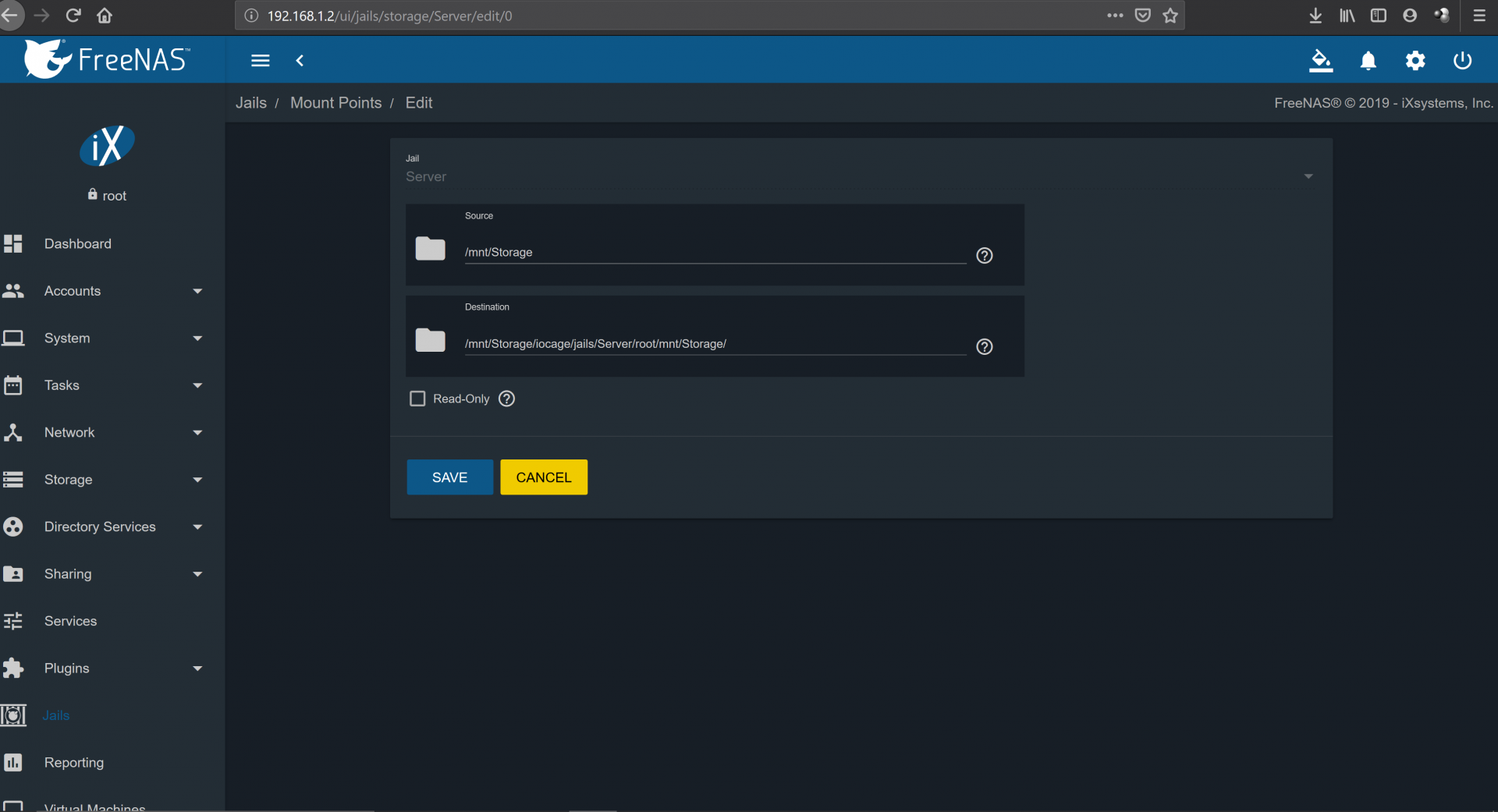

That is what it looks like... or, mostly (attached is a screenshot)...

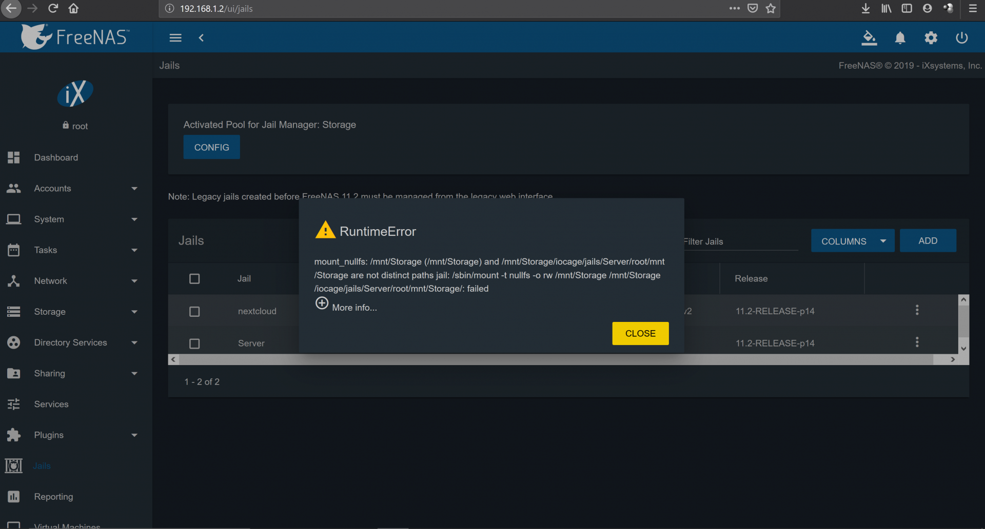

THe problem is, when I go to launch the jail, it kicks back an error... (also, screenshot 2)

You should mount /mnt/Storage/media or something similar and not /mnt/Storage. Looks like you did not read garms remark on loops or the popup in my screenshot.

/mnt/Storage contains /mnt/Storage/iocage and thus creates a loop. You solved the loop so maybe you can set your thread to solved?
