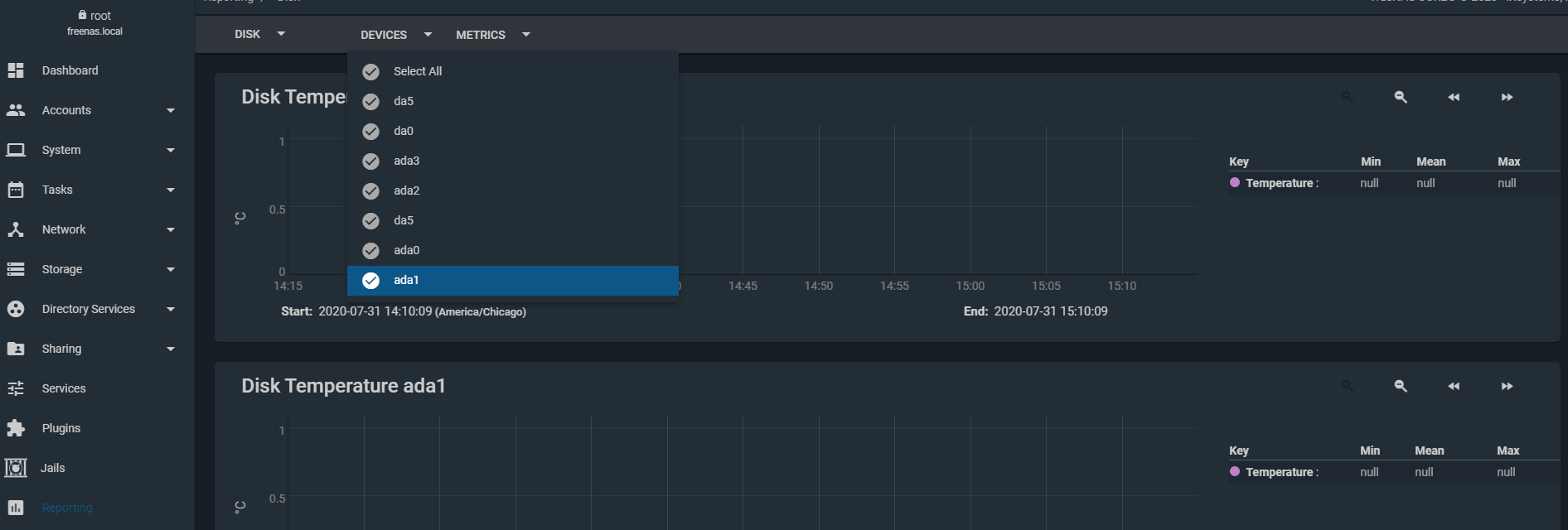

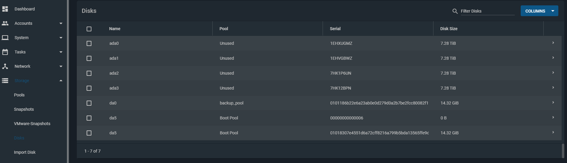

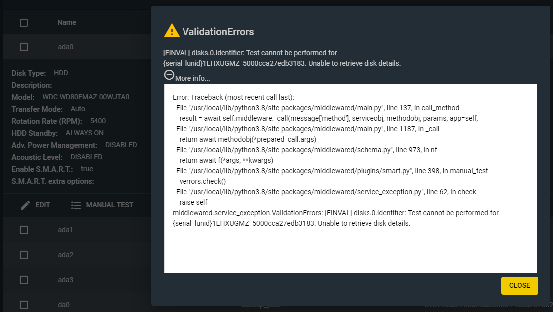

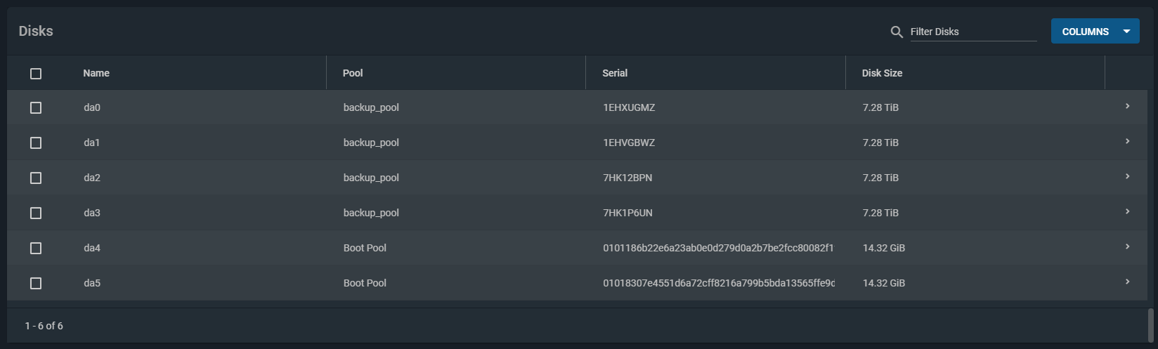

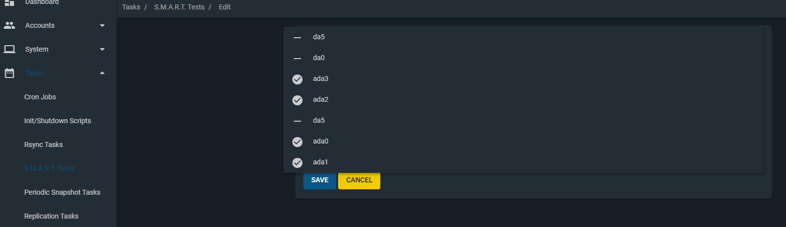

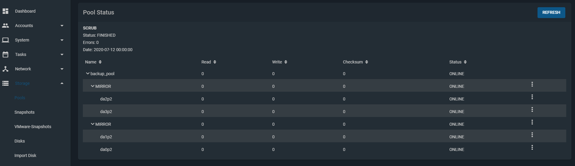

In some places in the TrueNAS web GUI, the disk names are incorrect. Previously, hard drives were ada0, ada1, ada2, ada3, and the boot drives were da0 and da1 (there was also a "residual" da5 that showed on the Disks list with 0B, even before I migrated to TrueNAS CORE that I never figured out how to get rid of). After switching the hard drives over to the the HBA card, the hard drives in FreeBSD are da0, da1, da2, da3, and the boot drives are da4, and da5. But, the disk list in the TrueNAS web GUI has not updated with the new names. ada named drives are still listed which don't exist, and not all the current da named drives show up.
I realize that "under the hood" these device names are dynamic, and that FreeBSD uses the gptid as a permanent reference for each drive. That is why things seem to be working. It's just that I can't get the web GUI to "reset" to the new device names. It is confusing, and could cause problems adding drives in the future.
Is this something I can fix, or should it be submitted as a bug?
What follows are screenshots and shell output for reference:
Incorrect names:
Correct names:
Incorrect names:
Correct names:
