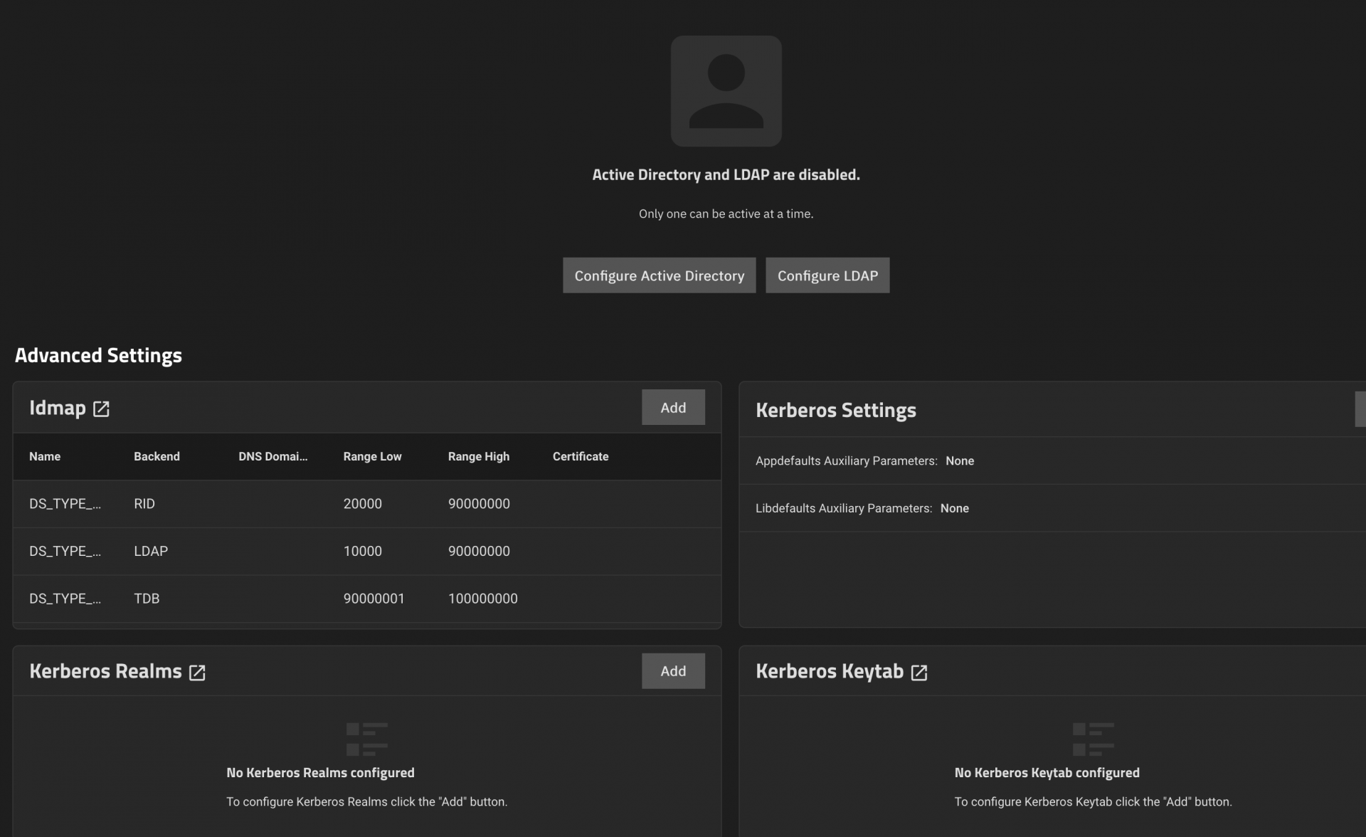

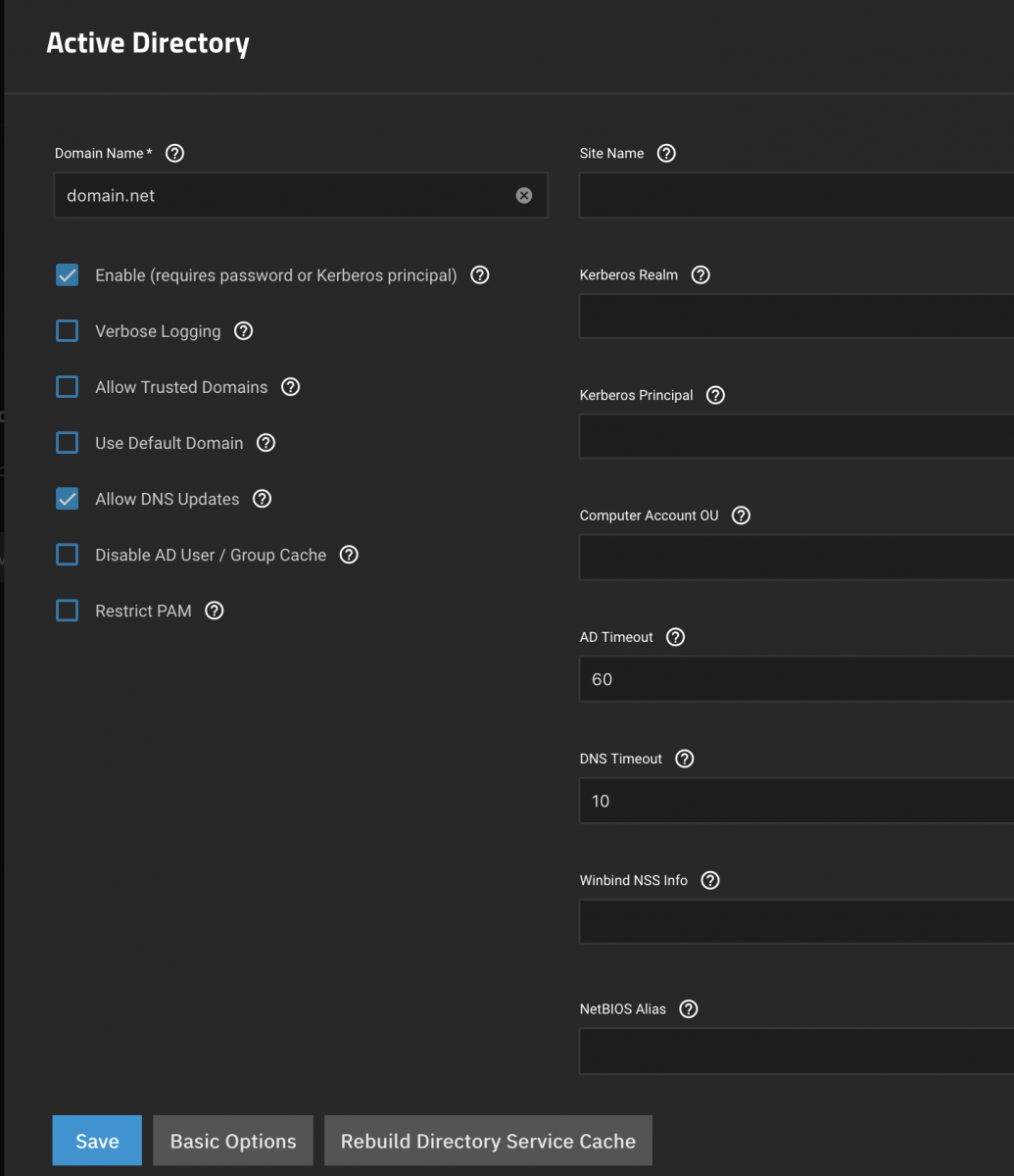

After entering wrong credentials to join Active Directory username and password fields seem to be gone from the UI and I am unable to rejoin the AD.
What I've done:
  1. Tried joining AD and input the wrong credentials.
  2. After the failure (unfortunately I don't remember what the error was.) I deleted the REALM and KEYTAB.
  3. When enabling AD there is no Username and password field so I am unable to rejoin the AD
The manual does say if you leave the domain or if DC is gone you have to clean up the configuration manually, however there are no steps to do so.
Screenshot of the screen:
Advanced page:
Any help would be greatly appreciated.

It looks like your AD form is still referencing the kerberos principle that you deleted. Try running following command from shell midclt call activedirectory.update '{"kerberos_principal": ""}'
This should clear out the stale kerberos principal and allow you to try to rejoin AD.
