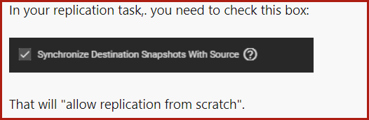

EDIT: For the record, I would not enable the option of "allow replication from scratch". It's a nuclear bomb solution to a problem that can (and should) be resolved with nuance. It's more important to make sure incremental replications work, rather than to have TrueNAS "just do it all over from scratch all over again!"
