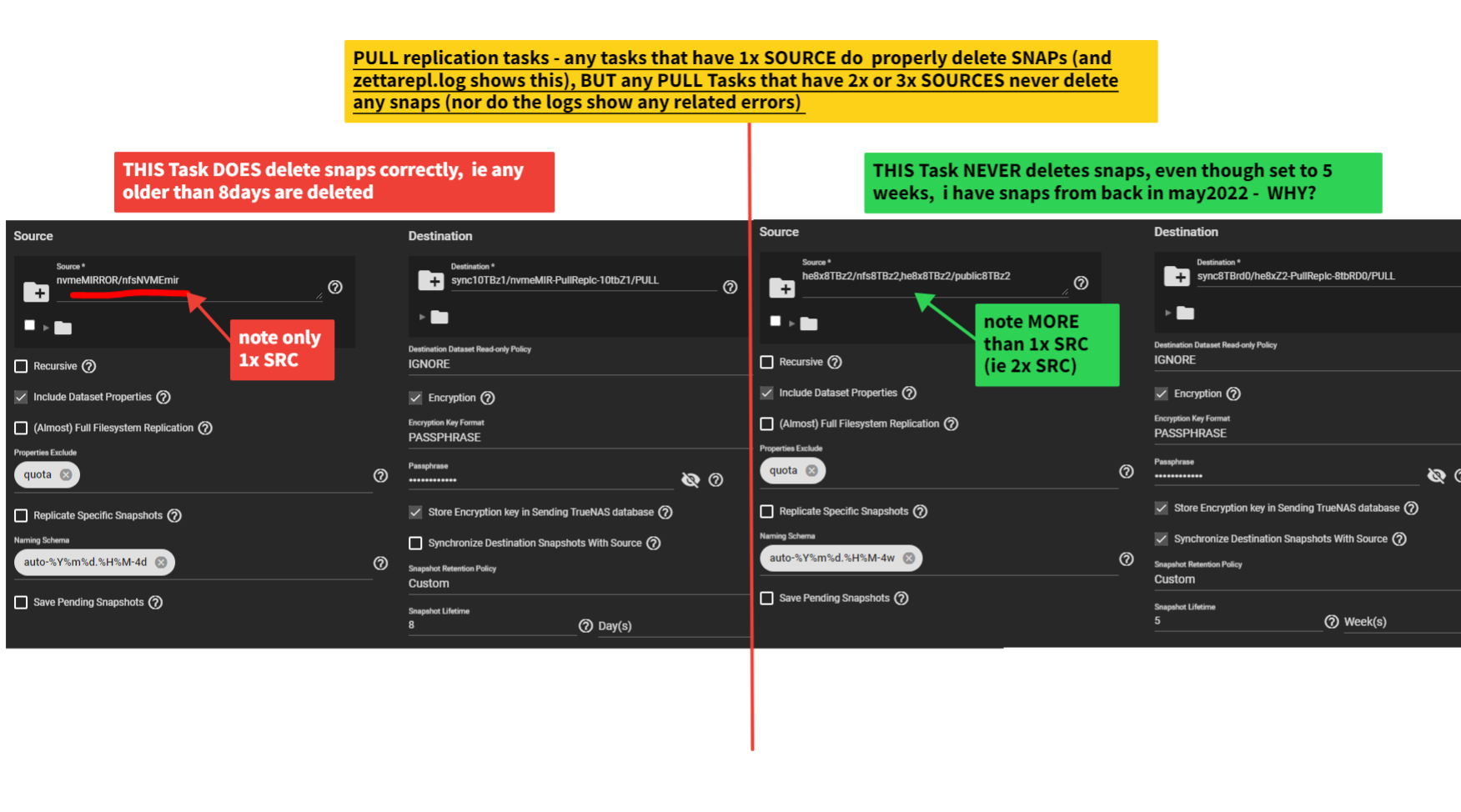

Im in the same boat, Im running TrueNAS 12.0 u8.1 , it is doing PULL replication from my main/master Freenas 11.3 box. This part is working great. However of my 5x PULL replication tasks, only 2x properly delete snapshots as defined my settings. There is clearly a bug here as my tasks have the exact same settings (ive even compared them at the CLI level via midclt call replication.query | jq ... just to be 100% sure its not a gui issue).
The best correlation ive been able to find, is that any Replication tasks that have MORE THAN 1x source dataset, will not delete snapshots properly. (no matter what settings you run, snapshots will just pile up, and based on the logs i dont even see an attempt at auto deleting snaps).
my 3x Pull replication tasks that only have 1x source (to pull from), do delete snapshots according to what i set in "Snapshot Retention Policy = 4 weeks" My snaps are named properly, ie in the format: "auto-20220530.0100-4w"
I agree the documentation is very poor, as are the names/descriptions of the options in the Replication task setup page (in fact some are quite dangerous! ive unintentionally wiped 9TB of remote backup data via the "Synchronize Destination Snapshots With Source" check box.)
images of what im referring to.

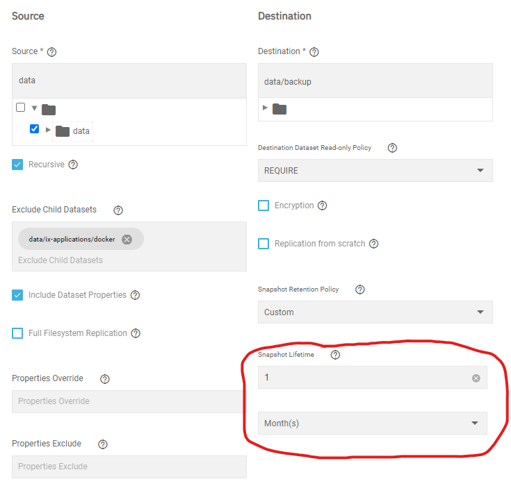

Same problem here. truenas2 pulls from truenas1 and ignores all snapshot lifetime settings:
But truenas2 does not delete snapshots older than 1 month...
So is this a bug or am I using it wrong?
