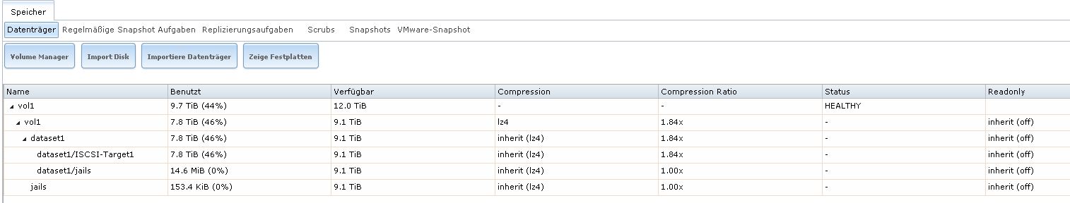

Push:
[root@freenas-99 ~]# zfs list
NAME													USED  AVAIL  REFER  MOUNTPOINT
freenas-boot										   1.72G   106G	31K  none
freenas-boot/ROOT									  1.69G   106G	25K  none
freenas-boot/ROOT/9.10-STABLE-201604140622			 8.54M   106G   503M  /
freenas-boot/ROOT/9.10-STABLE-201604181743			 5.14M   106G   462M  /
freenas-boot/ROOT/9.10.1-U2							1.67G   106G   665M  /
freenas-boot/ROOT/Initial-Install						 1K   106G   493M  legacy
freenas-boot/ROOT/default							  6.73M   106G   500M  legacy
freenas-boot/grub									  25.3M   106G  6.33M  legacy
vol1												   7.81T  9.03T   153K  /mnt/vol1
vol1/.system										   34.1M  9.03T   166K  legacy
vol1/.system/configs-241bf4dd02d1413596a7e0d91081dbbf  19.9M  9.03T  19.9M  legacy
vol1/.system/cores									 11.5M  9.03T  11.5M  legacy
vol1/.system/rrd-241bf4dd02d1413596a7e0d91081dbbf	   153K  9.03T   153K  legacy
vol1/.system/samba4									 320K  9.03T   320K  legacy
vol1/.system/syslog-241bf4dd02d1413596a7e0d91081dbbf   2.08M  9.03T  2.08M  legacy
vol1/dataset1										  7.79T  9.03T   103M  /mnt/vol1/dataset1
vol1/dataset1/ISCSI-Target1							7.79T  9.03T  4.58T  /mnt/vol1/dataset1/ISCSI-Target1
vol1/dataset1/jails									14.6M  9.03T   153K  /mnt/vol1/dataset1/jails
vol1/jails											  153K  9.03T   153K  /mnt/vol1/jails

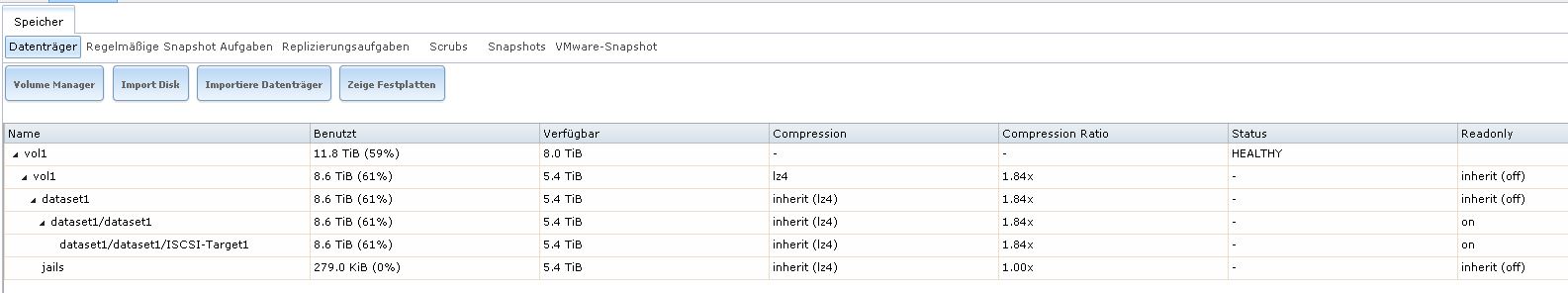

Pull:
[root@freenas-101 /mnt/vol1/dataset1/dataset1]# zfs list
freenas-boot													  1.51G   106G	31K  none
freenas-boot/ROOT												 1.48G   106G	25K  none
freenas-boot/ROOT/9.10-STABLE-201606270534						11.6M   106G   606M  /
freenas-boot/ROOT/9.10.1-U2									   1.46G   106G   634M  /
freenas-boot/ROOT/Initial-Install									1K   106G   463M  legacy
freenas-boot/ROOT/default										 10.2M   106G   473M  legacy
freenas-boot/grub												 19.0M   106G  6.33M  legacy
vol1															  8.63T  5.36T   279K  /mnt/vol1
vol1/.system													  3.97M  5.36T   302K  legacy
vol1/.system/configs-9ea32b00462f407e85fe38994184205a			  407K  5.36T   407K  legacy
vol1/.system/cores												1.63M  5.36T  1.63M  legacy
vol1/.system/rrd-9ea32b00462f407e85fe38994184205a				  279K  5.36T   279K  legacy
vol1/.system/samba4												442K  5.36T   442K  legacy
vol1/.system/syslog-9ea32b00462f407e85fe38994184205a			   965K  5.36T   965K  legacy
vol1/dataset1													 8.61T  5.36T   279K  /mnt/vol1/dataset1
vol1/dataset1/dataset1											8.61T  5.36T   279K  /mnt/vol1/dataset1/dataset1
vol1/dataset1/dataset1/ISCSI-Target1							  8.61T  5.36T  4.85T  /mnt/vol1/dataset1/dataset1/ISCSI-Target1
vol1/dataset1/dataset1/ISCSI-Target1-auto-20161027.0703-2m-clone  23.2K  5.36T  4.85T  /mnt/vol1/dataset1/dataset1/ISCSI-Target1-aut
vol1/jails														 279K  5.36T   279K  /mnt/vol1/jails

It looks like your Pull dataset1 is read only. Did you set that, or was it done automatically by FreeNAS? You can try changing the settings to read-write (both dataset1 and dataset1/iscsi-target1) and then rerun the mount command.
bramble
Oct 26, 2016
17
You are right! it's set to read only but wasn't set by me.
where can i set it back to read/write? looked under "edit" at the dataset settings but couldnt find an option.
depasseg
FreeNAS Replicant
Sep 16, 2014
2,874
zfs set readonly=off vol1/dataset1/dataset1
and possibly
zfs set readonly=off vol1/dataset1/dataset1/ISCSI-Target1
then re-run the mount command.
bramble
Oct 26, 2016
17
and possibly
That did the trick!
Thank You!
