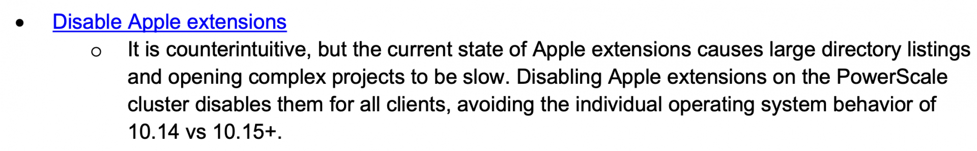

Alternate data streams = on. Having them off leads to problems and performance degradation
Apple Extensions = off - seems to always improve performance. Most dramatically on mixed SMB/AFP shares, only slightly on SMB only shares
Is there any clear disadvantage of keeping them off?

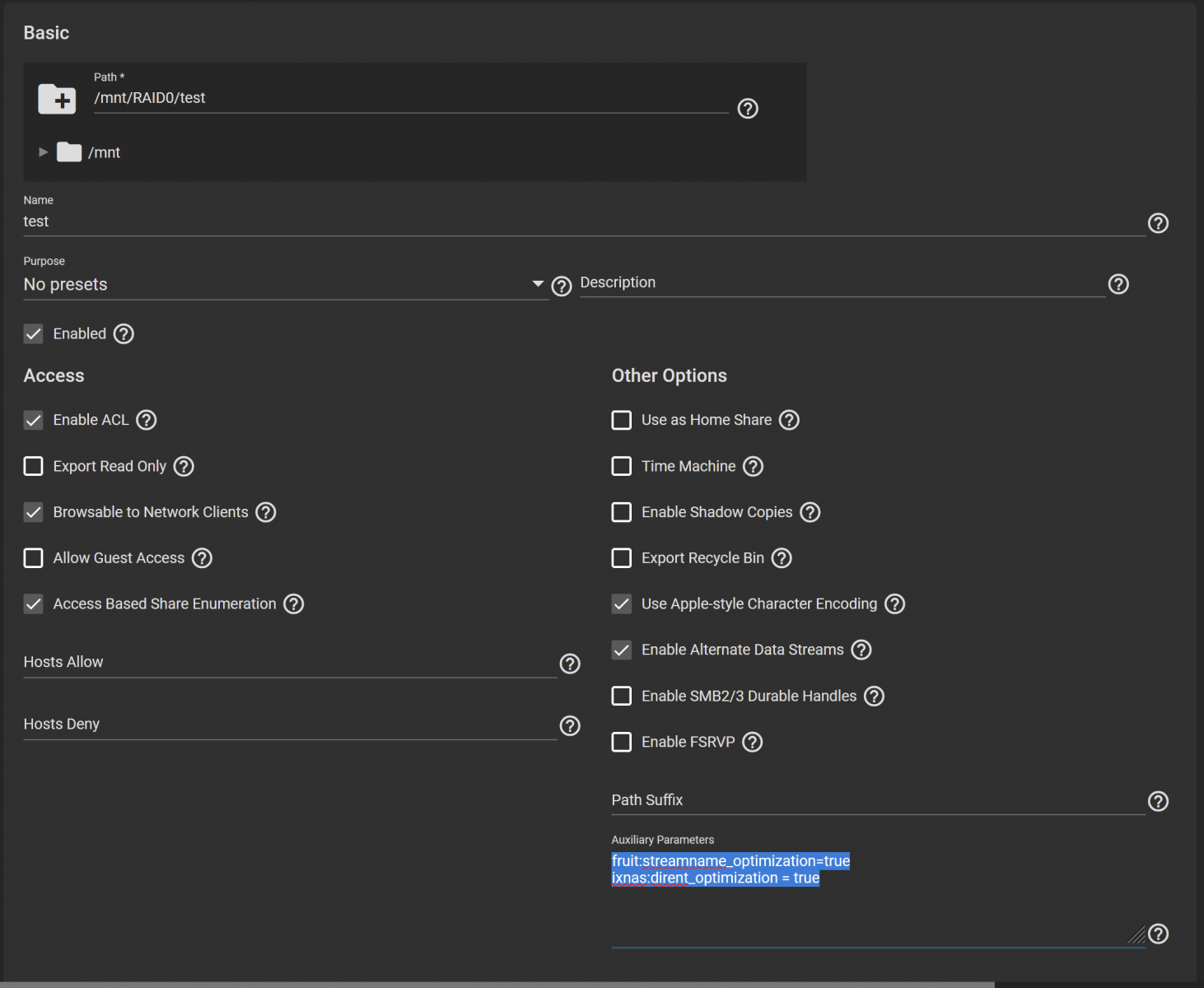

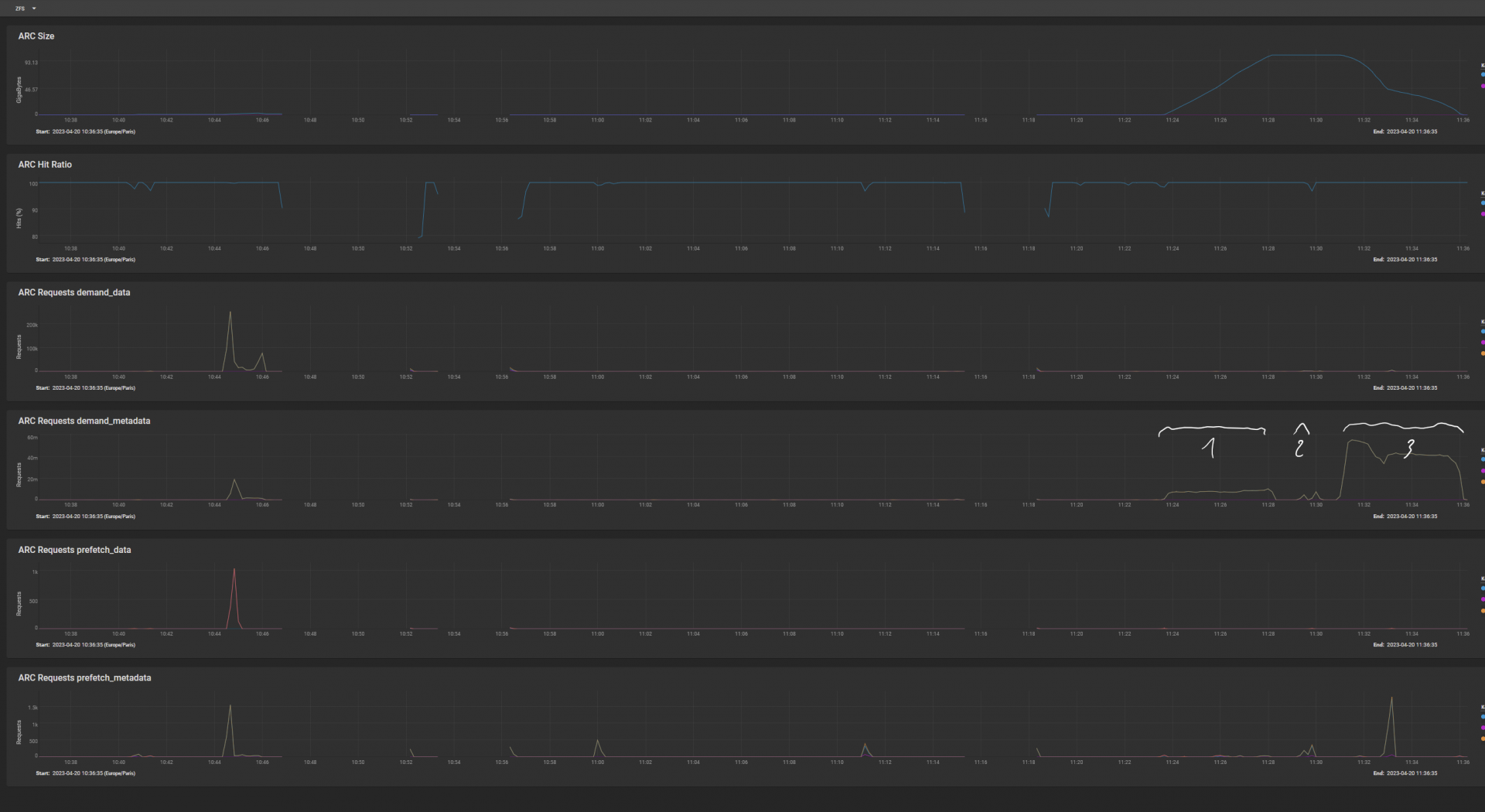

I've tested this morning. First tests with default settings on the mac (no nsmb.conf and leaving the usage of DS store over network enabled)
the new version on Truenas and
fruit:streamname_optimization=true ixnas:dirent_optimization = true
107GB 16k items
I get almost the same performance on copying (1) and browsing (2) (folder open) 5min to copy, 2/3 second to open a folder between 2500and 8000 items.
Delete (3) is closer to 5 minutes instead of 6 so it's better.
Smbd processes still goes to over 80% in spikes during delete

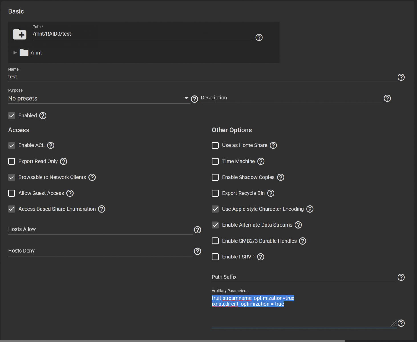

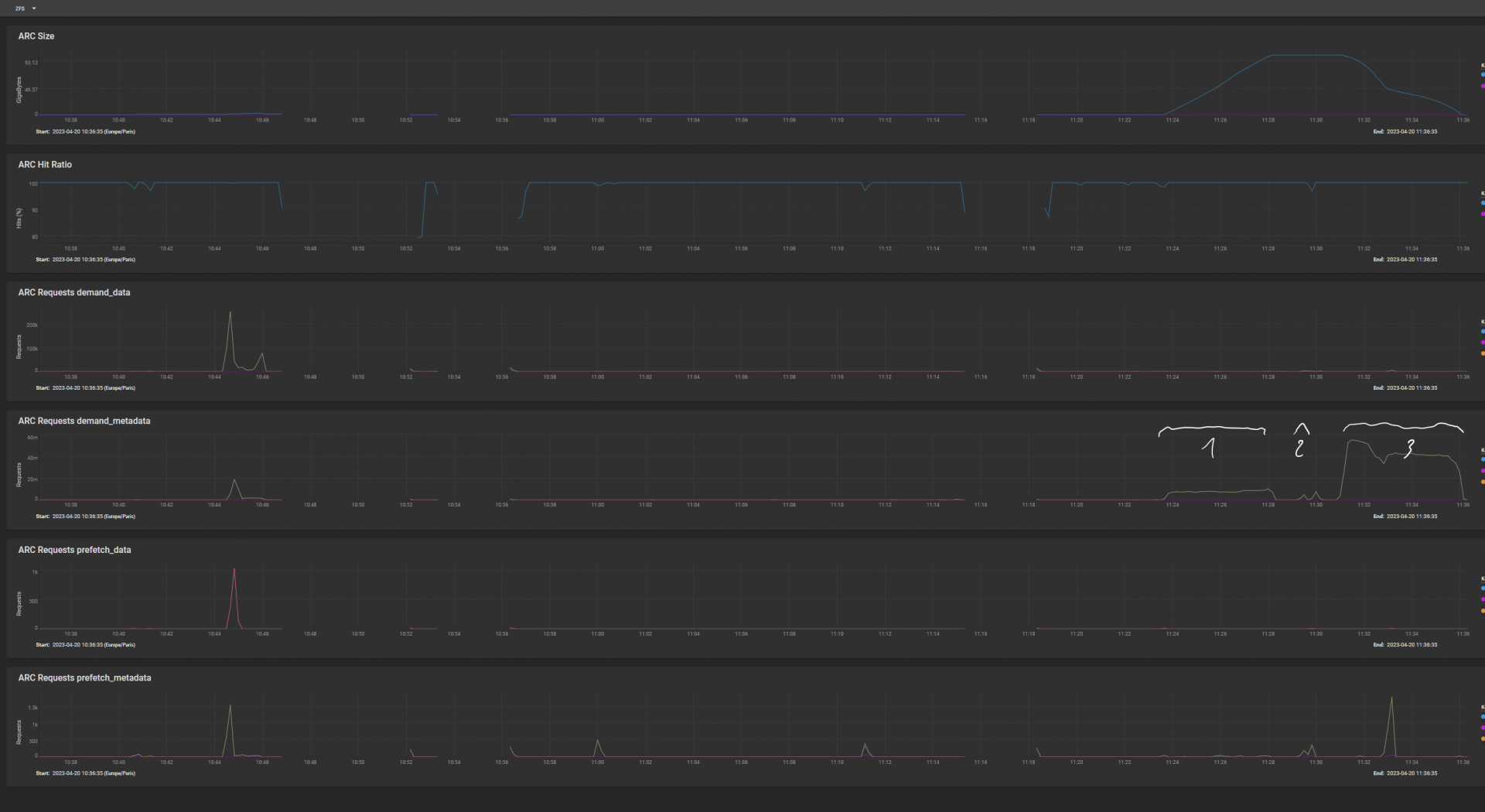

107GB 16k items
