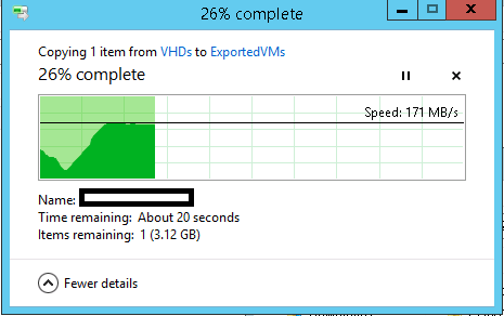

Here's some windows <-> windows transfers: (two different transfers, but pattern is identical across both)
[See 'Screenshot #1' in post #10 at later point in thread] (sudden drops to 0 byte/s, stays like this for a few seconds)
[See 'Screenshot #2' in post #10 at later point in thread] (sudden 'recovery')
Note: I have 10G connections between Windows shares as well as Windows and Samba.
If I disable packet filtering on the pfSense, these issues go away. The Samba transfers work at full speed, and the windows transfers don't experience the initial hiccup / recovery. Simply setting rules to pass everything doesn't help, but disabling packet filtering entirely does. (Obviously unacceptable, but this is test env. and not primary firewall)
Here's another windows <-> windows transfer through pfSense, but this time with packet filtering disabled:
In my case, my general configuration is a bit complicated. I have pfSense virtualized as well as in a HA configuration (this is on Hyper-V, unfortunately), but another firewall does NAT. PfSense in my case only does routing / firewall between a set of subnets. (Shutting down the second pfSense instance doesn't seem to improve anything, so I don't think it's related to HA, and I don't believe there are any asymmetric routing issues in my case, either.) The pfSense logs seem clear of any traffic relating to this.

Screenshot upload works in a new post:
Screenshot #1:
Screenshot #2:
