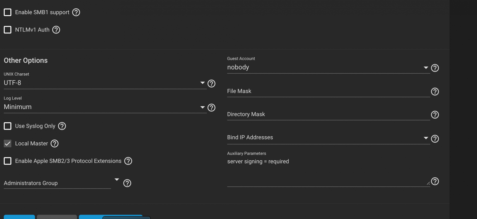

Have you tried setting server signing = required as I mentioned earlier?
