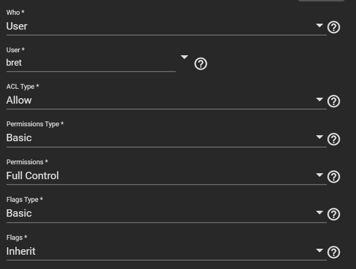

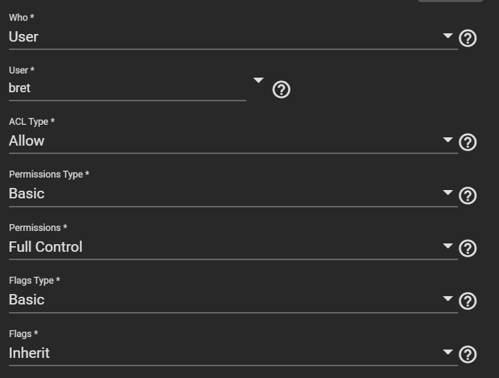

I have applied permissions for this account though to the smb share:

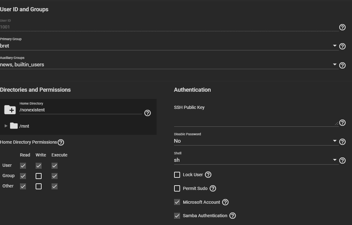

Here is the account:
