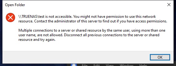

Might not be a 23.10 specific issue, but this has not bothered me before so i'm giving it a shot here. Cannot for the life of me figure this out.
I keep having this issue where SMB Access is denied on Win10. It worked fine when only Plex was installed, but somehow during installation and setup for qbittorrent (specifically after i enabled VPN in the application - i transfered the config file over SMB) it broke. I can't figure out what changed. Tried setting up a new "clean" share, still same issue. Both with admin account and a newly created different account. Auth log says NT_STATUS_NO_SUCH_USER
I've tried setting up a new dataset with SMB share type, and a SMB share where everyone@ has all access. Still my admin account can't open it. Only if i set guest access on can i use the share.

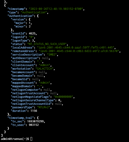

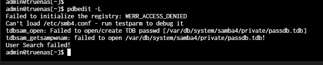

Do you have a local user "Admin" that is also an SMB user? NO_SUCH_USER means that the user doesn't have a passdb entry.

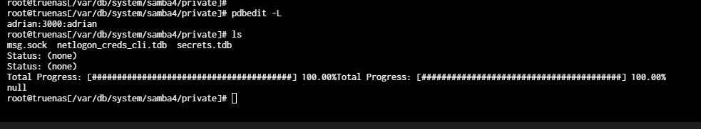

Disregard the previous message (which isn't approved yet, so feel free to remove it) - i forgot sudo. with pbdedit i get the user i created, but not the admin user. Following some of your earlier advice i checked for the passdb and it's not there - syncing it just gives a "null:"
Trying to auth SMB with the created user 'adrian' gives the same error:
but nothing in the auth log.

Your client is using the username admin which doesn't exist on the server (per log message you posted above). Your passdb command was rejected because you didn't do it via sudo / root (this is also expected).

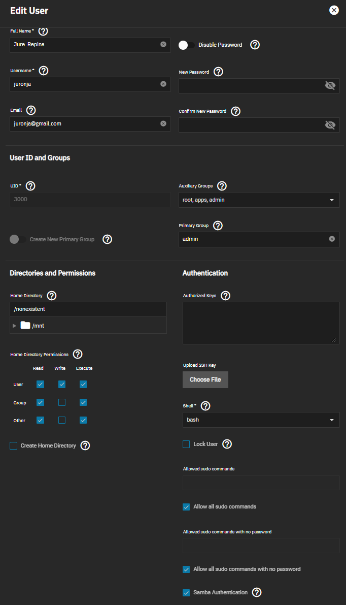

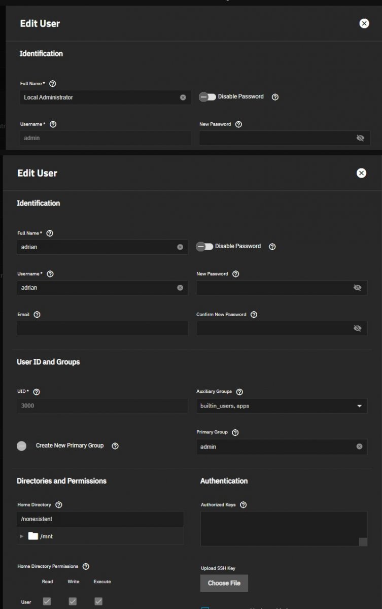

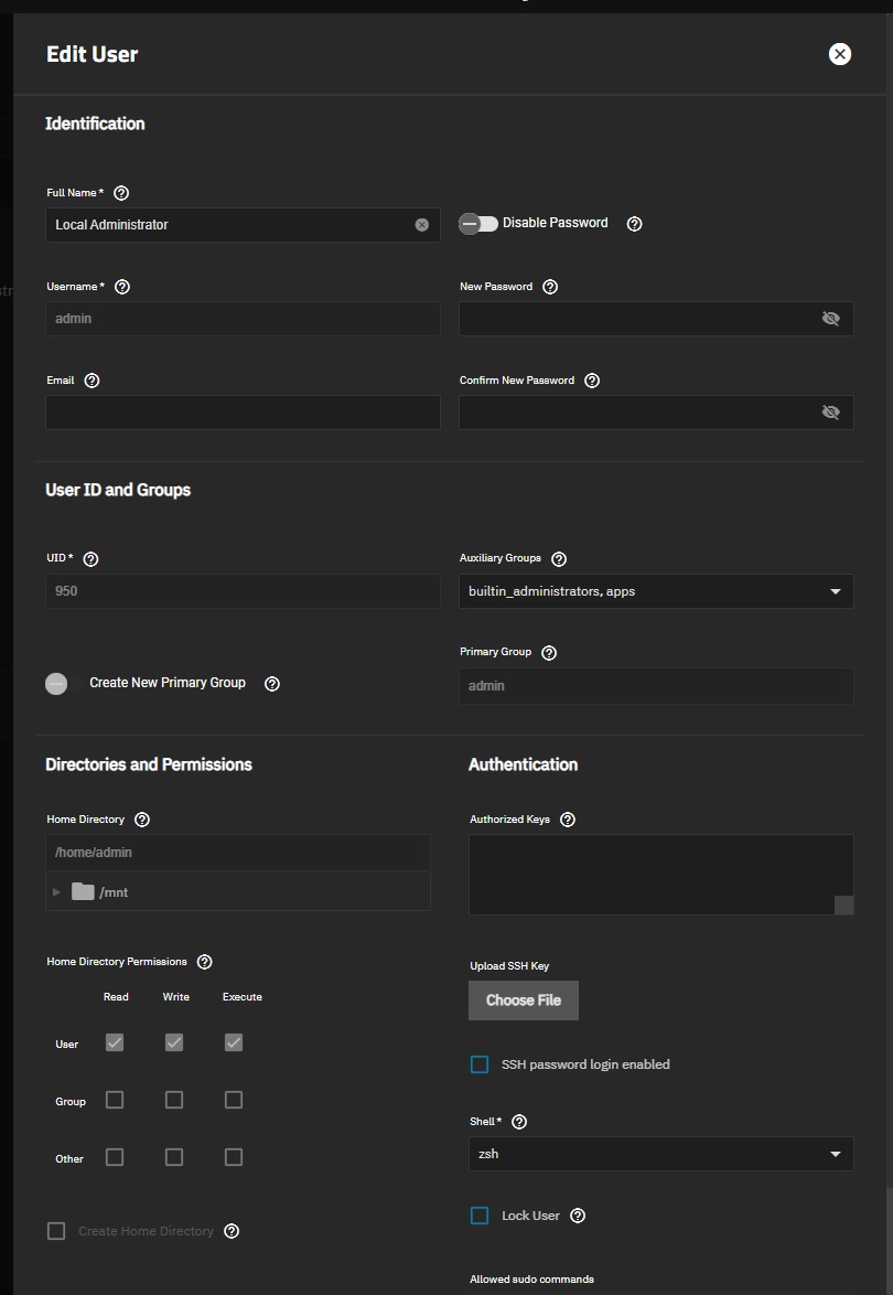

In your screen captures for edit user admin, I don't see the box labelled "Samba Authentication" for admin user. On pre Cobia, it's on the bottom. Is that checked?
Your screen capture ends at "allowed sudo commands".
anodos
Sambassador
Mar 6, 2014
9,553
Generally we don't allow either admin or root to be SMB users.

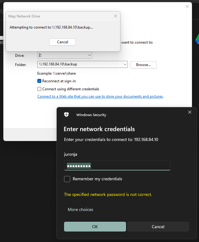

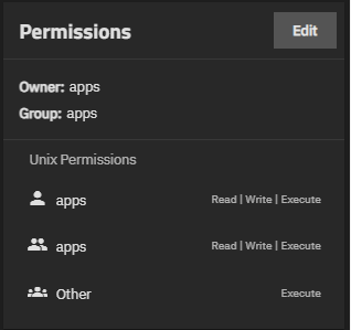

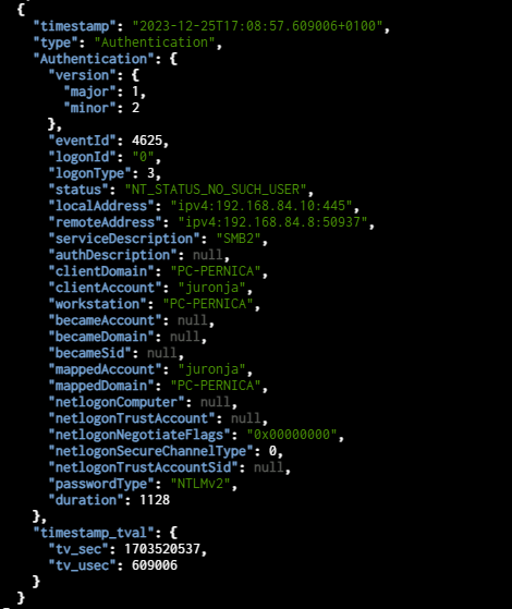

hello, I have the same problem, but my user is juronja.
- password is 100% correct
- user is not built-in
- has smb auth checked
- is part of apps group
- apps group has ownership and permissions
- Network Security: LAN Manager authentication level is set on NTLMv2 only.
Any ideas how to further debug? Thank you
