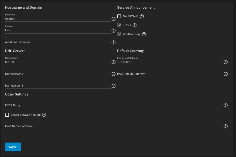

It sounds like your Network | Global Configuration may not have DNS defined or the Default Gateway may be missing.
Svedriall
Mar 9, 2022
5
Sadly, I couldn't figure out what the problem could be about the DNS nameserver or my gateway, tried giving it my local DNS provider as well, error stays the same.
Error: graylog had a failure Exception: RuntimeError Message: pkg.FreeBSD.org could not be reached via DNS, check graylog's network configuration Partial plugin destroyed
If i configure some things manually, I can then install, basically doing NAT manually, but that ends up being un-reachable.
You can find my Global Configuration screen below.
9,700
