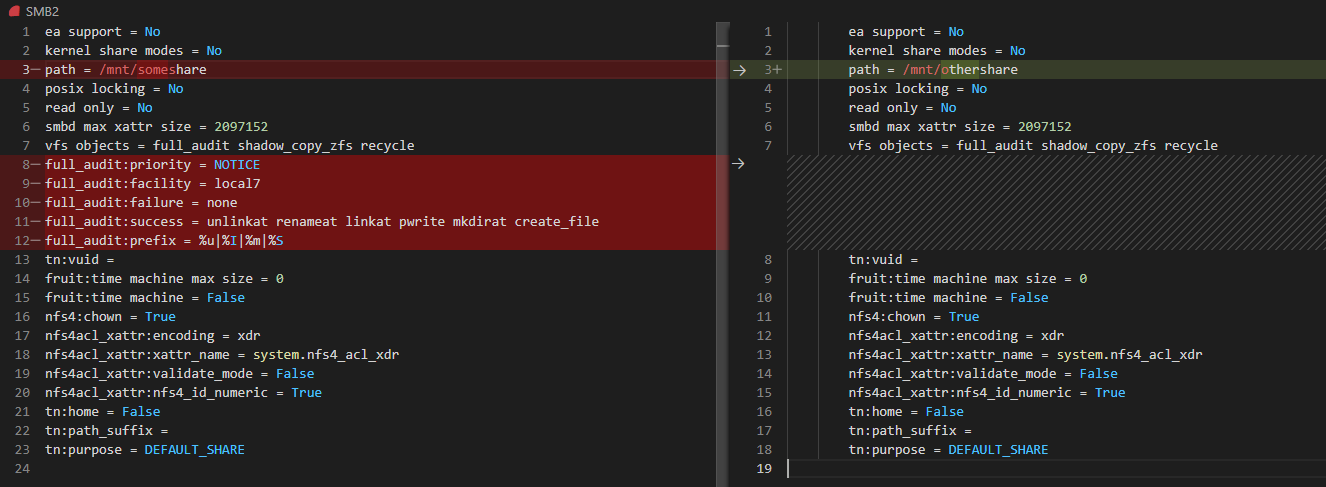

Thank you Patrick, is this
Compare the output of testparm -s of a working configuration with one with your auxiliary parameters enabled. Probably there will be something missing in the latter configuration, because TrueNAS seems to drop certain "automatic" parameters if auxiliary ones are present.
Add whatever is missing as auxiliary, too.
what you mean?
It seems both are very similar.
Patrick M. Hausen
Nov 25, 2013
7,776
That's what I meant. I'm surprised by the result - sorry, no more ideas. Possibly take it to the Samba folks?

I noticed the comparison was wrong and it came from a dataset that was not extensively set with permissions so it was probably not valid either.
I came up with this so far:
TN SCALE
vfs objects = full_audit recycle streams_xattr shadow_copy_zfs nfs4acl_xattr zfs_core io_uring
full_audit:prefix = %u|%I|%m|%S
full_audit:success = unlinkat renameat linkat pwrite mkdirat create_file
full_audit:failure = none
full_audit:facility = local7
full_audit:priority = NOTICE
TN CORE
vfs objects = full_audit recycle shadow_copy_zfs ixnas aio_fbsd
Both Permissions and Logs seems to work so far with this.
