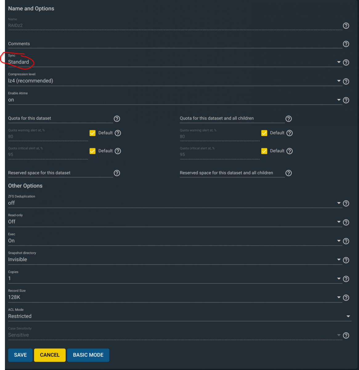

hi folks, just wanted to clarify one setting:
snyc setting is set to standard, so it depends on software if async writes or not.
background story is, I recently switched from windows on my desktop to manjaro and I just got half of the speed without changing network/server/hardware.
So it must be in dependency of software on my desktop.
therefore the question, is the standard sync setting different from the os (for instance linux vs windows) client?

If I recall correctly, SMB writes by default are async, unless the application otherwise specifically requests sync writes.
My first guess would be an issue with the linux drivers for your network card. In order to rule out any network issues, I would recommend doing a network performance test between your desktop and a different system. There are a few different network testing programs out there. Make sure you're doing RAM-to-RAM in order to avoid any storage system bottlenecks.
If you set sync=disabled, does it make a difference?

tried it out
Sync =always -> ~12mb/s
sync = disabled -> 52mb/s
standard -> 52mb/s
so it is not that setting causing low speeds.
Ok, back to linux community :D
