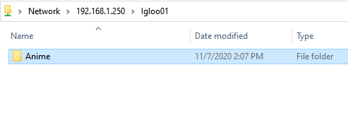

More Details of what I could find by searching deeper and deeper while I lose my head in this newer permission fudge.
I can see the Anime Folder but nothing else from the dataset and SMB Share

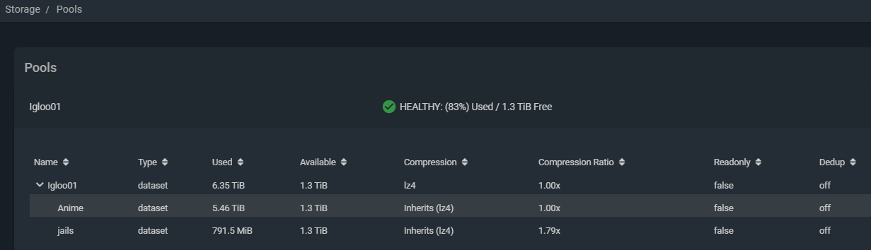

Managed to use the Shell and move all the Folders off my root dataset /mnt/Igloo01 to the main share dataset /mnt/Igloo01/Anime with the mv source_dir target_dir command

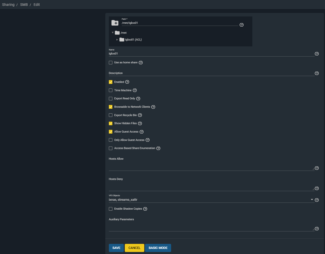

Created the SAMBA share to /mnt/Igloo01/Anime and set the ACL to Open with my Igloo user account and guest group for the ACL recursive.
Guest Connections Allowed
I can now access the SAMBA at the root /mnt/Igloo01/ without any hiccups.
