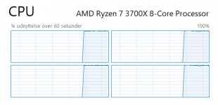

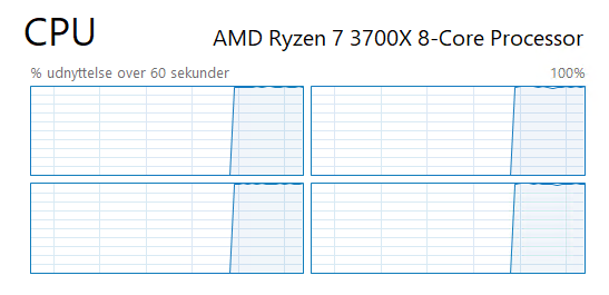

In the VM, i see that task manager uses nearly 100% CPU on all cores at the same time.

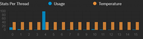

So i went to the dashboard, and i find that CPU core 4 is at 100%, all other cores are practicaly at zero.

I forgot to attach photos of the CPU usage, i think it looks weird.

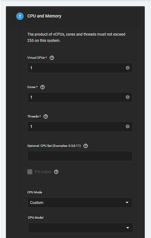

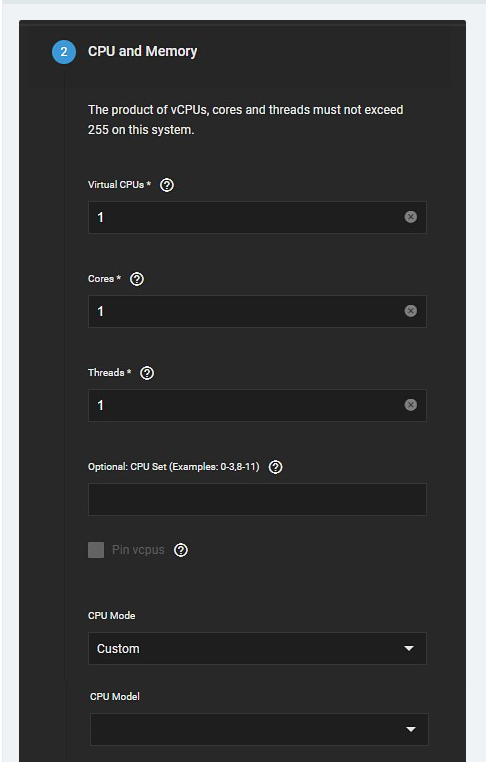

Aaaaah, i found it!
The option for "Optional: CPU Set (Examples: 0-3,8-11)" i had set it to 4, and when doing that you only allow it running on CPU 4.
When i press the questionmark to see what the option is, it doesent show my any info, so a Google of that option. Bingo.
I now have a speed monster!

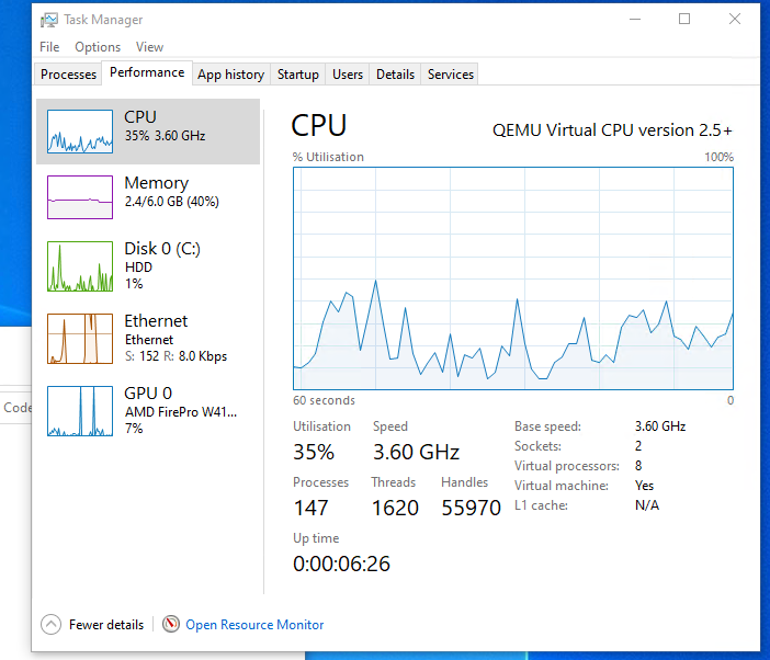

The other thing that accelerated my Windows 10 VM is hyper-v enlightenments turned on.
I use this guide for pinning:

Yehar i know.
And i have tried a lot of other configs.
Aaaaah, i found it!
I might just try Scale again on bare metal and spin up windows. I gave up and had results just as you described. Ended up with scale on proxmox and windows vm on proxmox all working great.

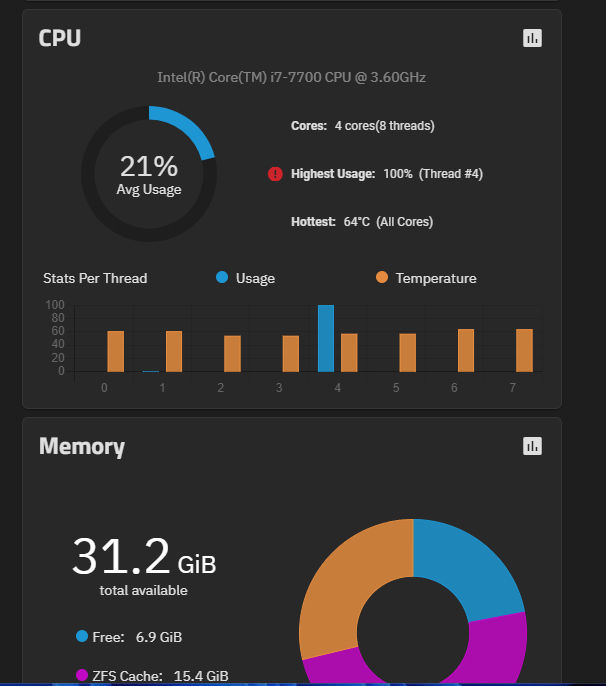

I have a spare dell i7 7700 I will try again with your tips. My main server I wanted to put it on is an amd ryzen 3400g with 64gb ram, asrock B550 pro-4 mobo
Here no? You just populated it with '4'?
Thanks
Yes there. With the number 4 it obly uges that one core!

If I set cpu set to just '4' this is pegged at 100% at start up then settles down with 2/2/2 also.
