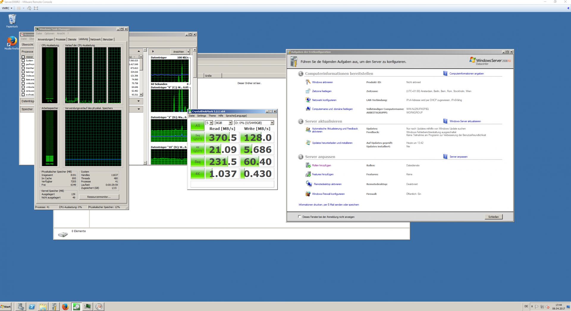

I have only one port connected - and I have really slow read and write speeds. While copying data to that machine, every minute the transfer drops to 0kb/s for some seconds and goes up to about 72MB/s in peak. This is waaay to slow. Everything is connected with gigabit and those disks are in one RAIDZ3 (yeah i know the risks about vdev size - does not matter here).
I did some previous tests, one FC cable all disks in RAID0 under Windows and a performance of nearly 400MB/s in read, and 130MB/s in write operation was seen.

If I only plug in 1 FC cable to one controller I do see 14 disks. Two cables each one to one controller showed me 28 disks. So that let me enable Mutlipathing. But I suggest the IO limit or bottleneck comes from the ESH4 NetApp controller, as they might be slow af when it comes to writes...
The test I did was 1: A Windows Server VM with the Qlogic card passthru and setup a raid0/stripe on Windows and make the speed test.
2: FreeNAS VM also on ESXi wiht HBA passthru and RAIDZ1, Mirror, wahtever. Stucked at slow write speed. Data came to the VMs with Gigabit speed
