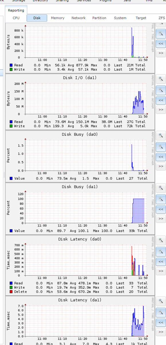

And then it just hangs here, GUI works so I looked at stats and it shows contact 100% load on DA1 drive (this volume) READING data at 120-200 MB/sec (see screenshot attached).
Original install 11.2U6 loads fine with all the settings if I detach the volume/controller from it. I tied even restoring settings in fresh 11.2U6 install and after reboot it's doing the same thing with SPA SYNC and reading the drives.
I am trying to have this volume working and not sure what else I can do, waiting doesn't help as all systems and versions just hang, is there anything else I can try as the volume it self looks healthy with no data curations and all scrub operations on it succeed with no issues.
