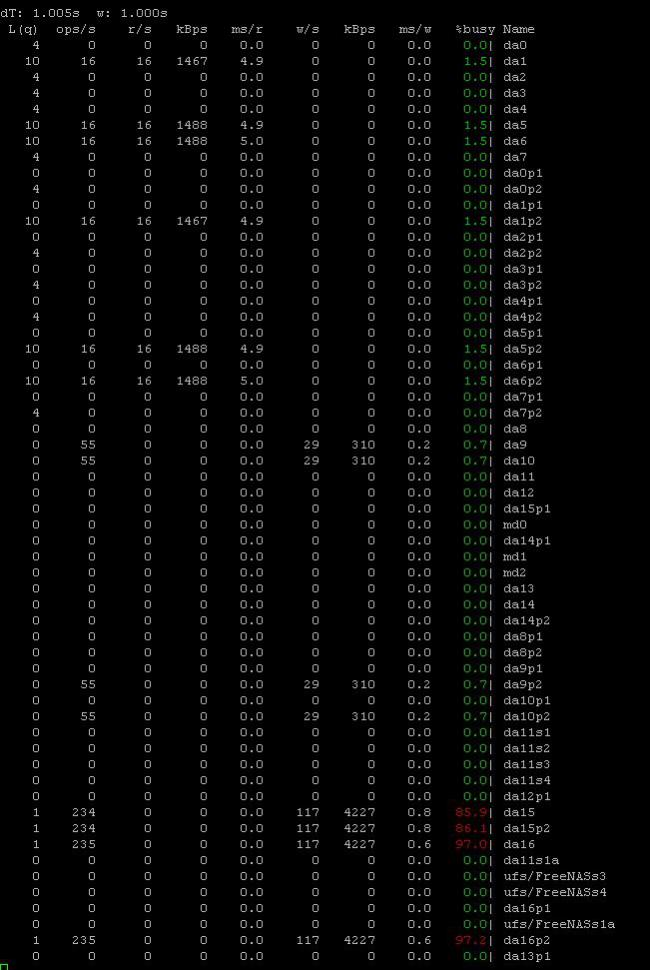

Hello,
I have two volumes setup.
Volume1 consists of 8 300gb 15k SAS drives, a 240GB SSD read cache, and a mirrored 50GB OCW Mercury Elite ZIL. The performance of Volume 1 is great, I am seeing 96MB/s write speed from ESX 5 with NFS over a 1 gigabit connection and far greater locally:
/mnt/Volume2# dd if=/dev/zero of=/mnt/Volume1/testfile bs=2048k count=50k
51200+0 records in
51200+0 records out
107374182400 bytes transferred in 284.522614 secs (377383649 bytes/sec)
Volume2 is a pair of 3TB Segate Sata Drives with a 120GB read cache SSD. I am getting 4 to 7 MB/s write speeds on these drives from the same ESX hosts (3 different hosts) using the same network link and NFS. When doing a local DD test I am getting about 140MB/s through put. Using gstat during the NFS writes shows both disks averaging 96% Busy. During the local DD test it shows 100% Busy
local dd test:
dd if=/dev/zero of=/mnt/Volume2/testfile bs=2048k count=50k

During nfs transfer this shows Volume2 getting 4M/s and gstat shows 96% busy on both disks. I've attached a screen capture of gstat during an nfs write
The local DD test shows results that I expected, but the NFS is extremely slow on writes. Read speed is fine
