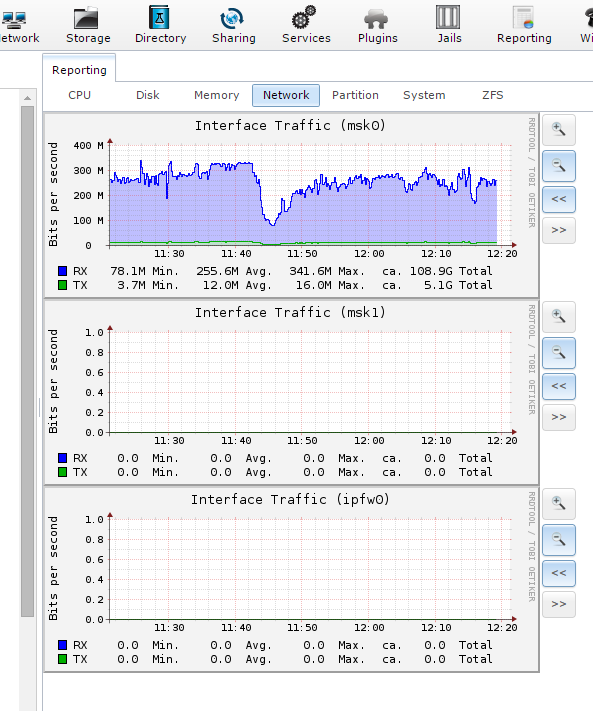

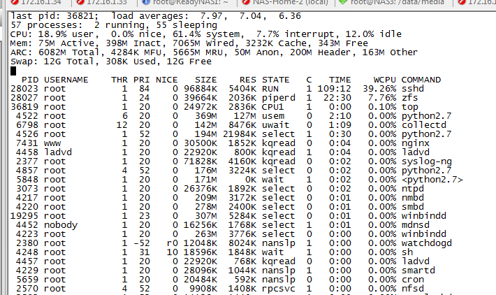

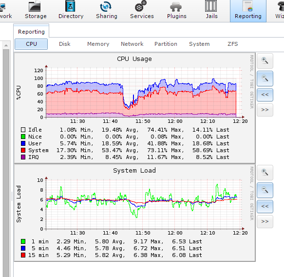

I'm just starting to use ZFS Replication from one server to a second on my local network. rsync would push the full 1G network, but I haven't seen anything close to that with ZFS replication. I've disabled both Stream Compression and the Encryption Cipher.
Does this seem normal? Is there anything I can try to improve performance? Is the CPU that limited?
Here's the PUSH system (full specs are in my sig):
Here's the PULL system (this is actually a Netgear ReadyNAS (upped to 8GB RAM) and an install of FN):
Here's some graphs from PULL:

High speed was slower than disabled. I'm just living with it.
I did a manual (CLI) ZFS replication as a test and it saturated the 1gb link, so I think there is an issue with SSH.
Sounds exactly like a CPU bottleneck then if changing to high speed cipher makes it slower.
The CPU you are using on the Pull system is about 1/2 the processing power that we recommend as the minimum, so I'd kind of call it "expected behavior". It also has the minimum RAM (8GB).
