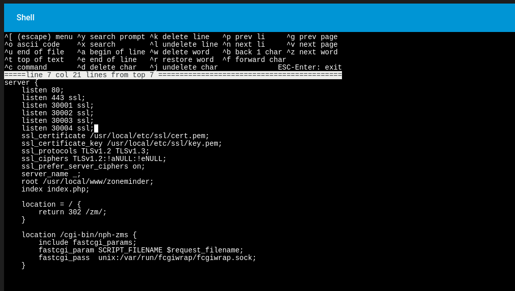

This is what I am doing right now:

So the FreeNAS zoneminder plugin is kinda broke, but still works great. I spent so much time messing w/ multiport settings/etc. No matter what I did I could not get more then 4 cams to stream.
Two changes need to be done to stream more than four cameras. The multi port stuff as talked about here, but there are not enough fastcgi processes avail to stream more then 4 cams.
fcgiwrap_flags was set to 4. For now I upped it to 10:
Everything is working fine now. I could not get multiport to work, but after doing the above, it works fine.
To get muliport to work I just followed the instructions after that and added some listen directives:
And fixed my zoneminder config:
All is well. Like I said, it took me a few hours to realize why mutiport is not working. I think I will file a bug soon to increase fcgi children in rc.conf
