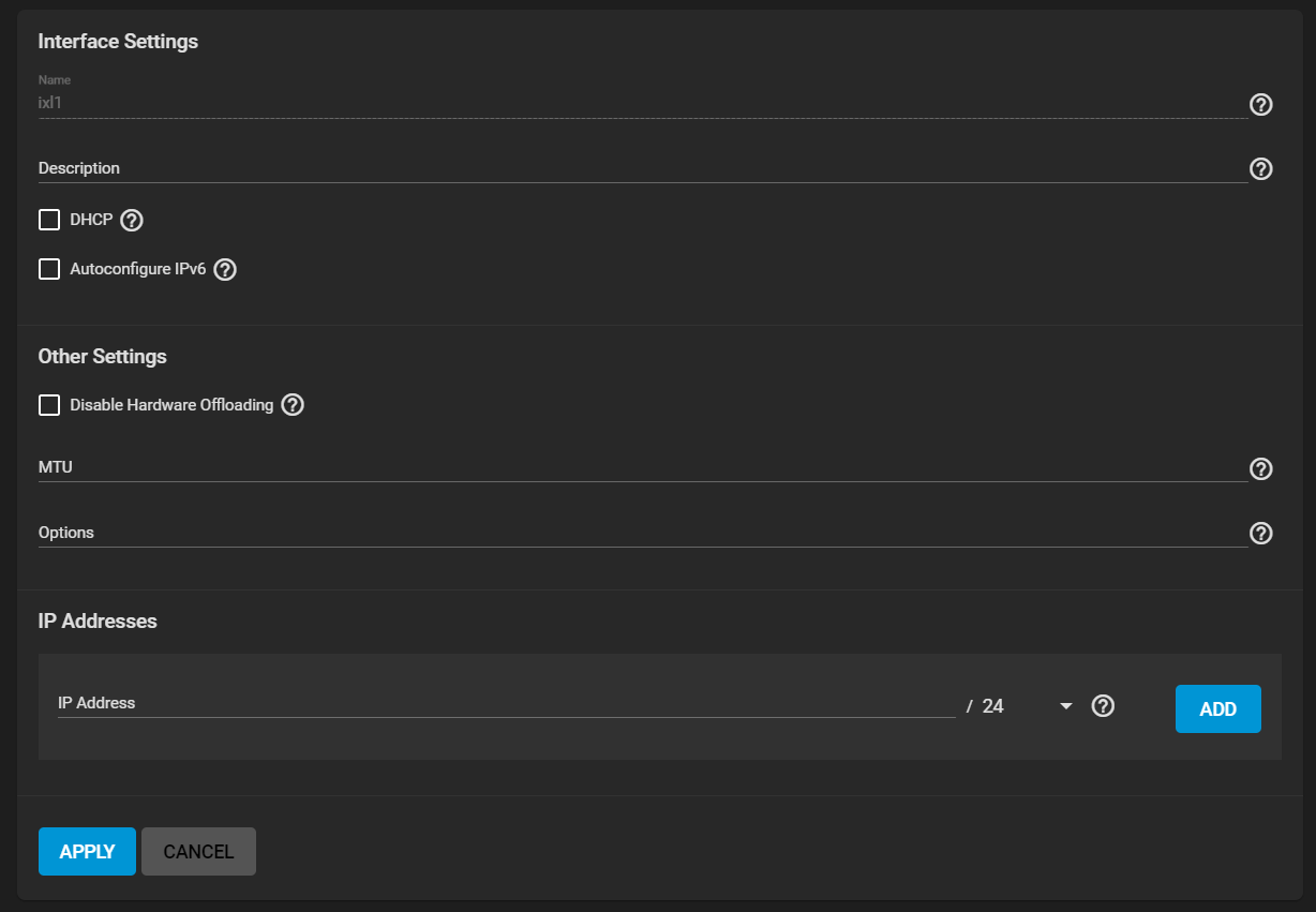

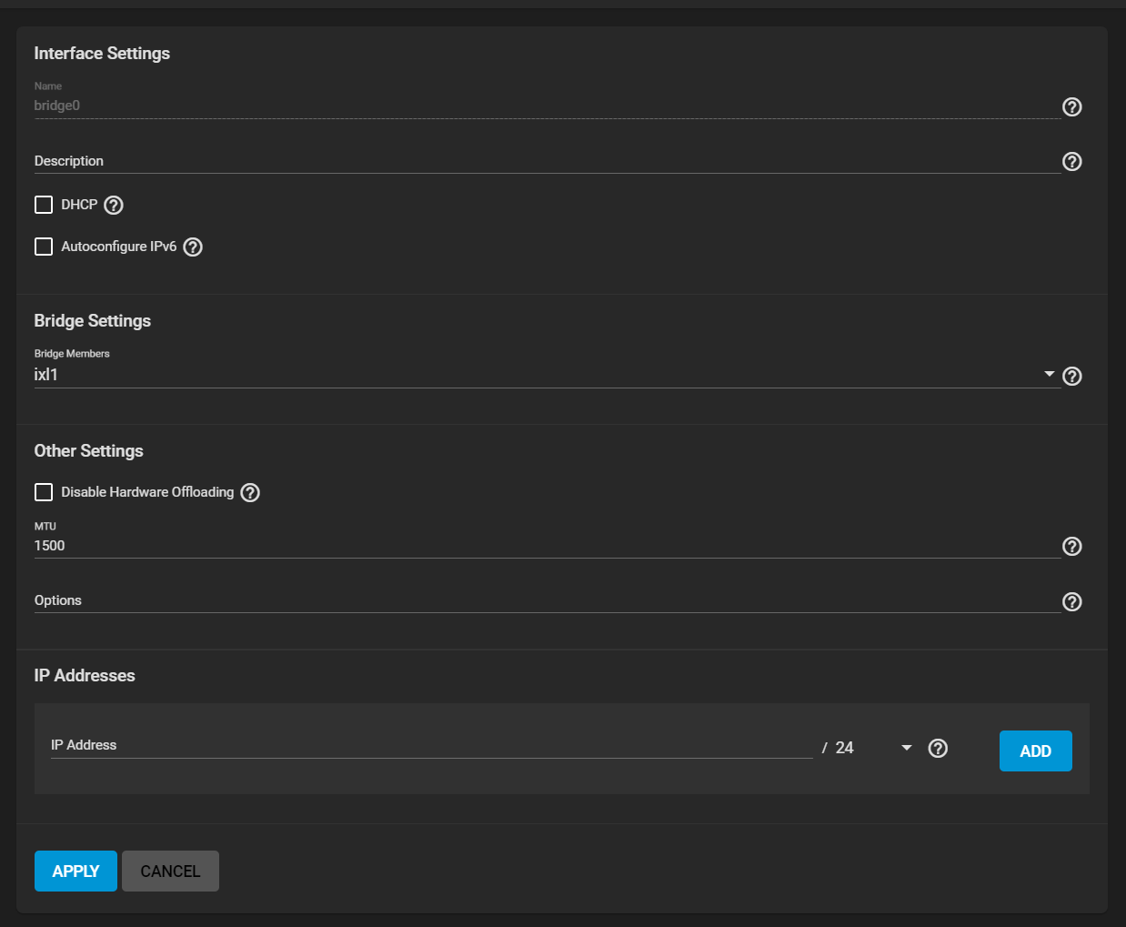

I have a simple bridge interface bridge0 -> ixl1
I have that bridge used in jails and VMs.
After I reboot, there is NO connectivity in any jails or VM. If I ifconfig ixl1 up in the shell, all jails and VMs immediately have connectivity. When I reboot, I checked the link status and it seems fine. All the status in UniFi controller regarding that switch port also seems great.

It may be a bug, but try tossing "up" into the options section, which should pass that through to ifconfig and bring it up at creation.

that seemed to work, thanks!
