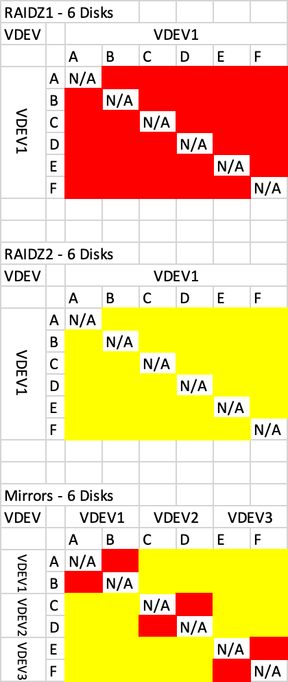

9,700
with RAIDZ2, any two drives can fail without data loss.
I had done the mapping for that and come up with a picture to help to explain that. Maybe it will help.
On the X and Y axes you have drives (A-F) one drive failing on each axis, then red for VDEV/pool loss and yellow for degraded VDEV/pool as a result:
